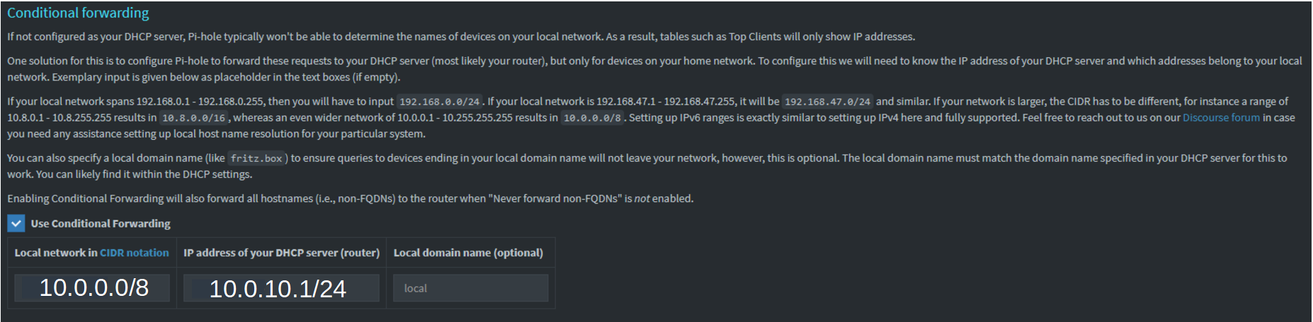

RPi-IP(Eth0) = 10.0.10.100/24
MikrotikRouterOS-IP(Eth2) = 10.0.10.1/24
For other Subnets first host bit + network address can be assumed as MikrotikRouterOS address IP.
