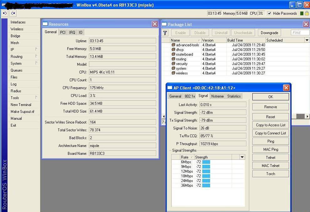

Tested on Ver.4.0Beta4 with limited package and it is rock stable, much better than ver. 3.xx
