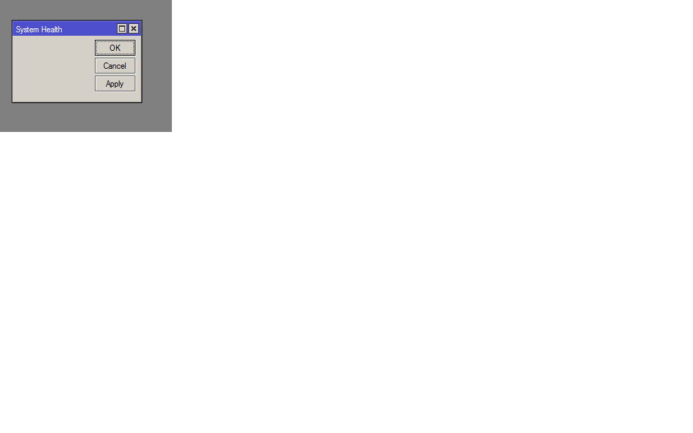

first BUG in rc4
rb411ah
[admin@mt] > system health pri
voltage: 1245V
:stuck_out_tongue_winking_eye:
maybe it suppose to be a 12.45v

can you try this board with higher voltage PSU, something like 18V or 24V? And are you sure you are running latest build. Anyway, create supout.rif file and send it to support@mikrotik.com
RB750:
RB411AH, 24V PSU
Chupaka, how do you like the winbox changes ?
