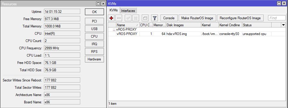

KVM isnt work with Intel E8400 cpu.
Yes, you are right, because E8400 doesn’t support hardware wirtualization (VT-x). Change CPU to VT-x capable and KVM will work.
I just use with rc04 or lower
http://www.intel.com/products/processor/core2duo/specifications.htm
e8400 DOES have VT thank you

same issue here. I had working VM on one core of my celeron E3300 - now it’s unsupported.
