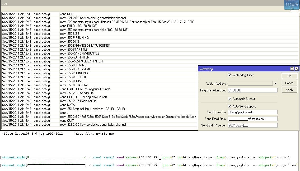

You can see that, if the watch dog reboot the bridge, i able to received the email notification with the supout file from the bridge.
but when i test the /tool send mail, it’s not working.
Look at the log debug output when it’s NOT working. According to what you’re showing email was sent. It’s impossible to troubleshoot based on a successful attempt.
On a side note you may find it easier to just use “/log print” and copy/paste the relevant parts than to resize log windows and take screenshots. It’s text, and this is a text forum. They’re kind of made for one another.
