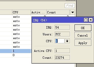

IRQ cause new problems can not be upgraded
Figure specify the CPU upgrade package can not be upgraded configuration upload no response after reboot
CPU power into the system to restore it to normal and auto reboot after the upgrade
translate.google
新的问题 IRQ 引起 无法升级
如图 指定CPU 配置 上传升级包无法升级 reboot 后无响应
断电进入系统 恢复 CPU 为 auto 后 reboot 才正常 并升级

Wish you allow me me help for some correction for this translation ^_^:
  1. The IRQ cause the system not able to upgrade.
  2. As shown in the photo, if using manual setting for the CPU. there is no respond after upload the files and reboot the system for upgrading purpose.
  3. Recycle the power, after enter the system, restore back the CPU setting to auto, then it can upgrade the system.
Yes, there are some issues with the multicore IRQ selection, it’s fixed in beta7
