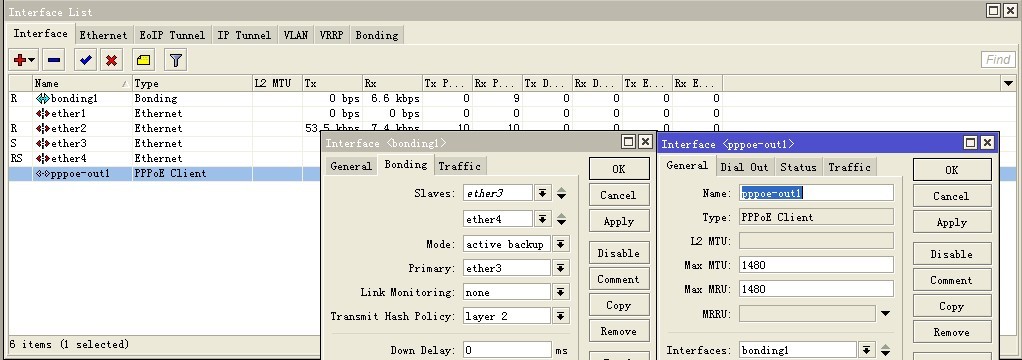

bonding might be some problems sometimes can not follow the desired work and cause system crashes, such as interfaces lost. . . .
pppoe mode can not have the desired effect?
NIC 82546EB X 2
Switch HP 2650(J4899B)
