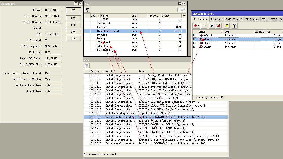

Thanks - boosted my 4core core routers throughput 2.5x, by manually assign interfaces to cores
And now with “/system resources cpu” menu, “/system resources irq” menu makes much more sense.
I also noticed that number of interrupts goes to 0 as soon as interface reaches some certain speed.
It looks like Linux Kernel enable NAPI: http://en.wikipedia.org/wiki/New_API. So on high speed routers i suggest to assign IRQs manually
