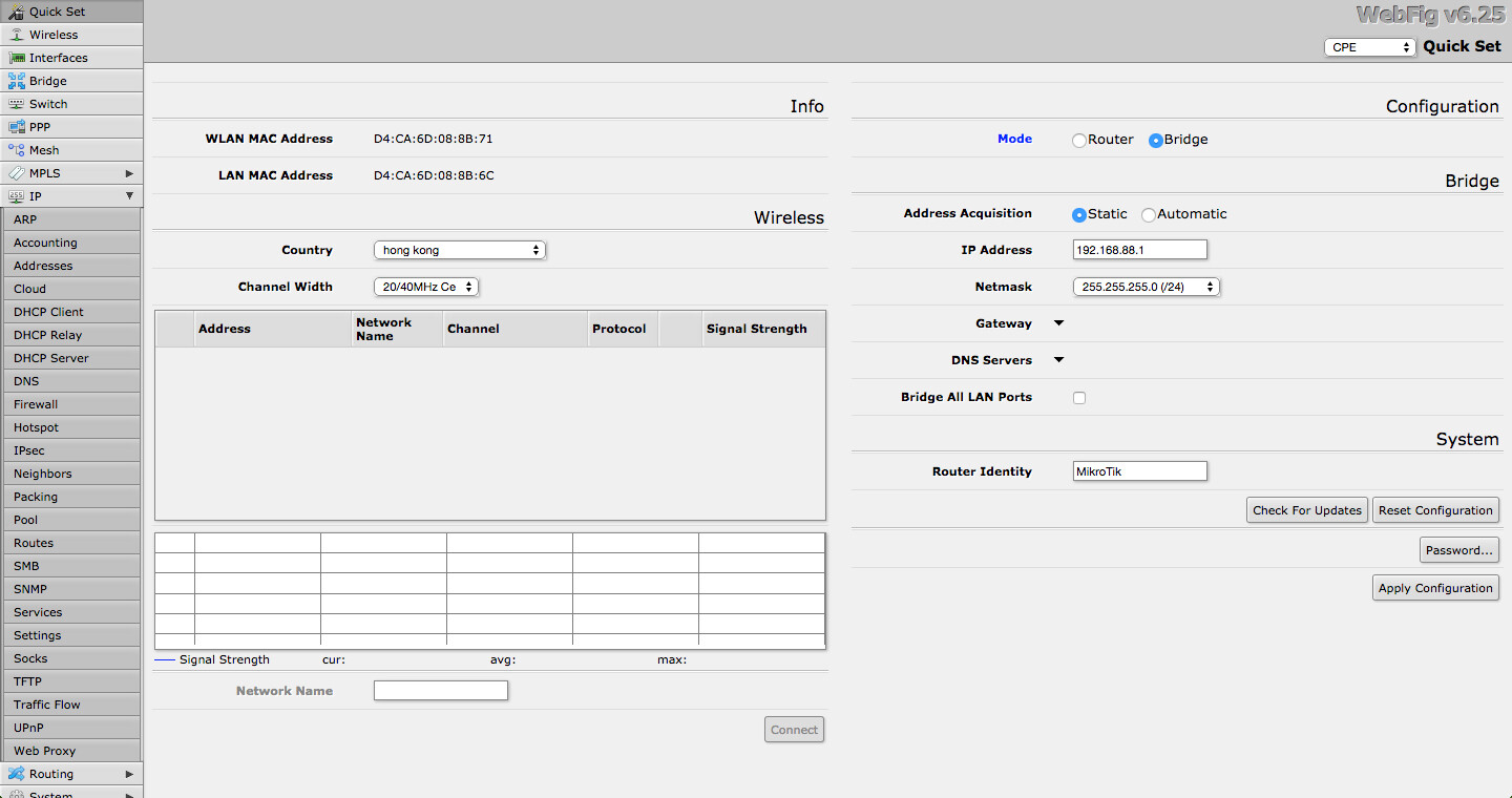

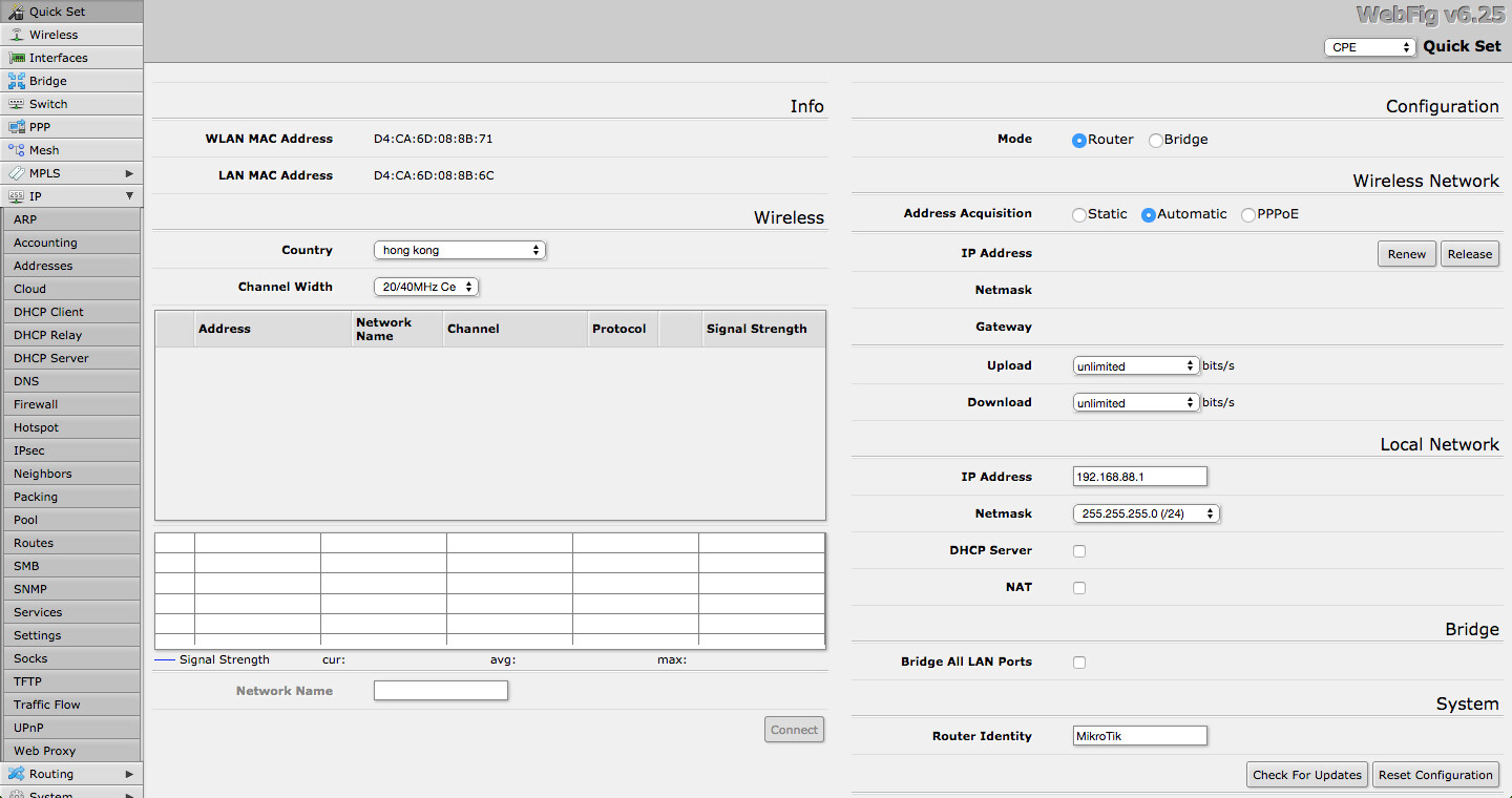

After upgrade to 6.24, my router is changed to bridge mode.
I have disabled the bridge-local in interface (this interface is enable before 6.24), then it have switched to router mode. But, it cannot show the IP address for WAN when it is set automatic.
