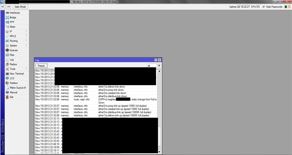

can anyone else confirm that port flapping still exist? mine does :neutral_face:

master ports show link status’s even though there is no cable plugged in?
