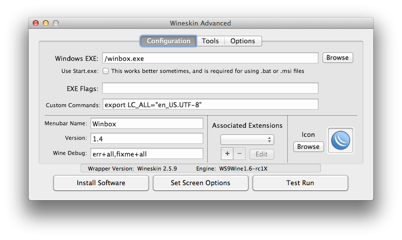

Add to Wineskin Advanced → Custom Commands: → export LC_ALL=“en_US.UTF-8”

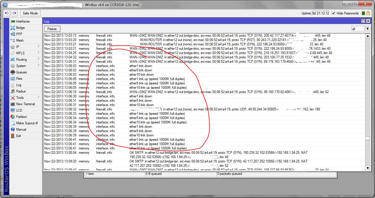

We are also seeing port flap on CCR1036 and RoS 6.6, FW 3.10
+1
Our CCR1016 does it too. (6.6, FW 3.10)
This needs to be fixed ASAP!!
yeah
it looks like this on my site.
before it was like in most screens only 1-2 port flaps. now it’s like this already for 2 weeks.

create launch shortcut with
env WINEPREFIX="~/.wine" LANG="en_US" wine "~/.wine/drive_c/Program Files/winbox/winbox.exe"
