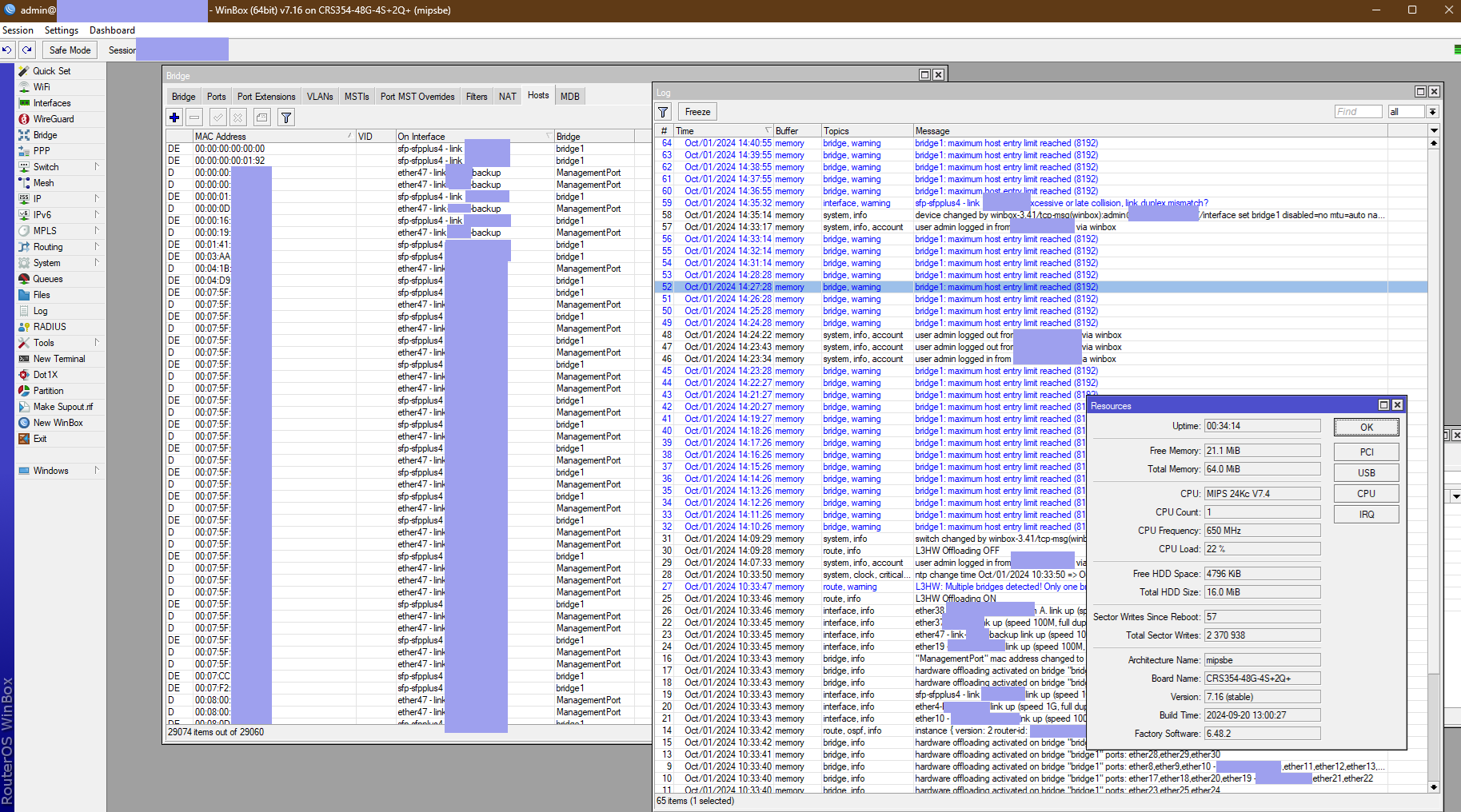

i have upgraded a few days ago some switches to RouterOS v7.16 and now the system log and the bridge hosts / FDB table is filling up and overflowing…. i have seen one of the switches crashing when it went above 60000 (60 THOUSAND) Hosts in the Bridge->Hosts table as displayed by WinBox… even if in the log it keeps saying “bridge1: maximum host entry limit reached (8192)”
it seems v7.16 is dumping random MACs (multicast?) in the same hosts table as regular ones - i even turned IGMP Snooping off and it keeps doing this.

while i was preparing the forum post here i watched it crash again… the hosts table grew to more than 66.000 items (i.e. it blew past 65535)… i looked away to another monitor… and saw in the corner of my eye the WinBox window return to the connect screen… when it came back i had a red crash message in the log. and an autosupout.rif waiting in the list of files - i have attached that to the support ticket also. ( kernel failure in previous boot, out of memory condition was detected)

i have looked through the supout.rif files that contain snapshots of the mac address tables from that day … there are barely a handfull of them that start with 01:xx, the majority seems random data… even the 00:00:00:00:00:00 one (in the screenshot below) seems random junk.

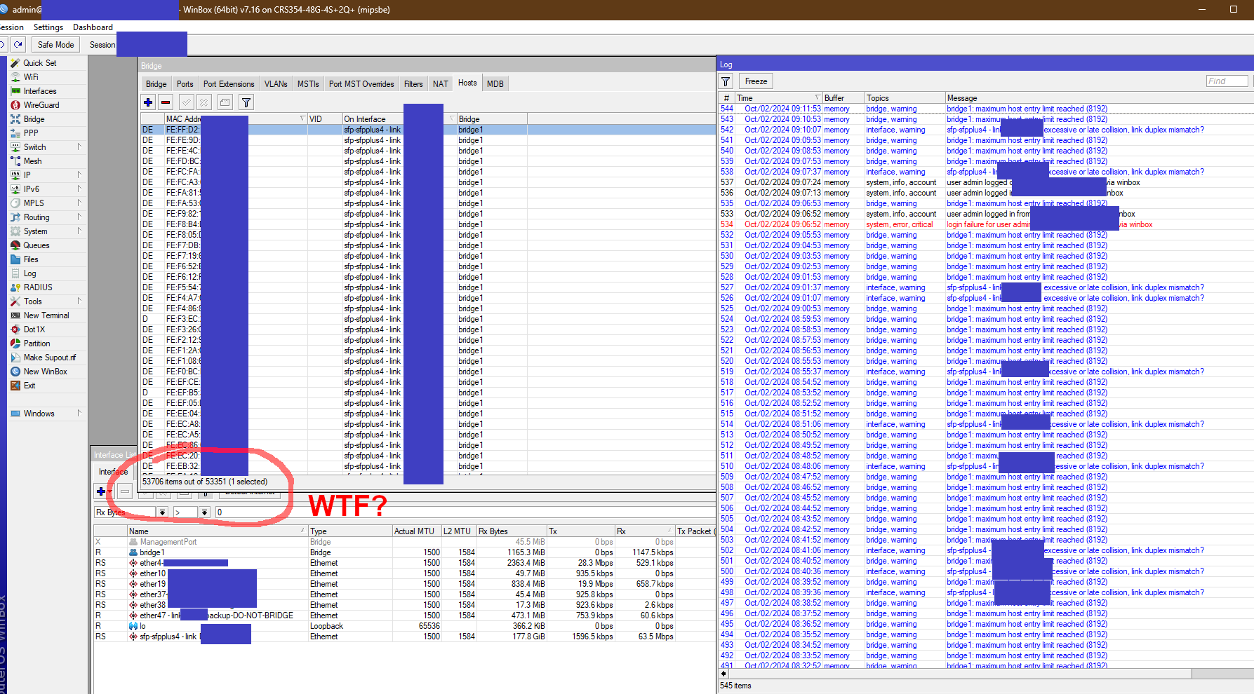

here is another screenshot that i made that day with them sorted in ascending order…
notes:
  • the screenshot was made before i reconfigured the backup link port, thinking that maybe that secondary/backup link bridge was the cause (but that was not the cause)
  • the 00:07:5F mac addresses are legit, we have many BOSCH IPTV cameras too.
