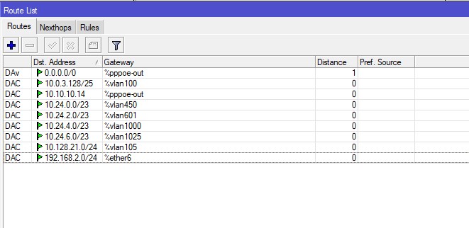

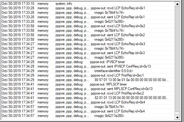

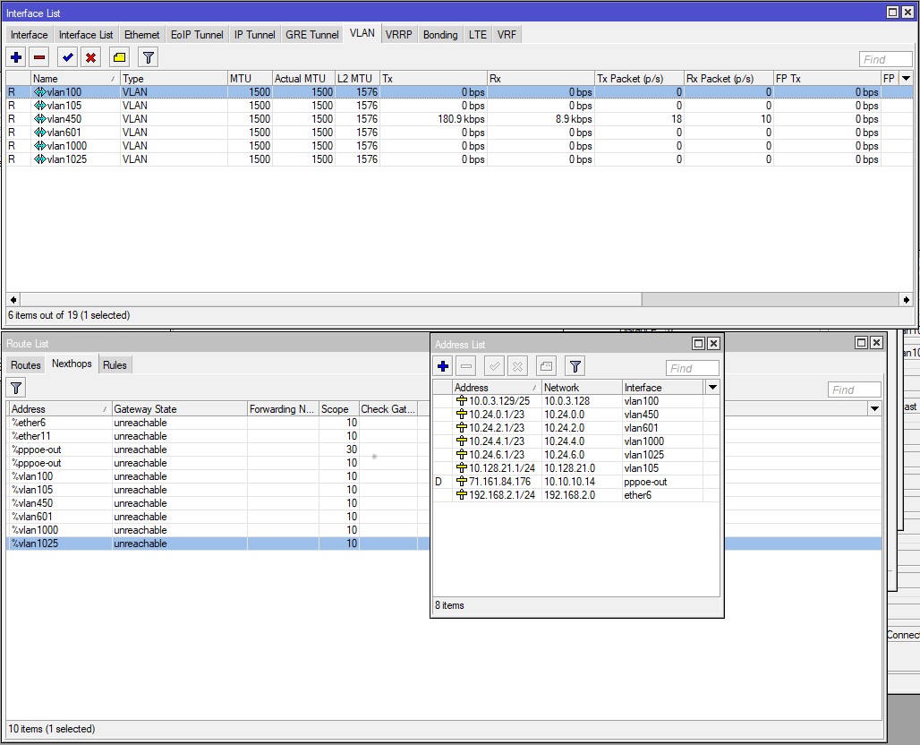

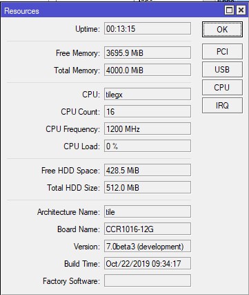

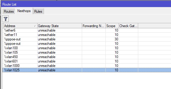

I upgraded my Cloud Core 1016 from v6.45.7 to v7 Beta 3 and my PPPOE WAN started acting up. Oddly enough I can ping out, resolve DNS, but browsing is intermittent from client computers (whether on VLAN or not). Remote management of Mikrotik works fine and Remote Desktop or TeamViewer to a computer behind the Mikrotik works fine. Watching the interface Status while trying to pass traffic, I can see it is at 0 kbps a majority of the time (both ether11 and pppoe-out). The routes look to be broken or at least not reporting right in the Route List.
