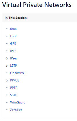

Hello, this is my first topic. I’m new in this Mikrotik world and have a dillema.
As I can see there are 12 different VPN systems integrated in RouterOSv7.
I would like to ask experienced Mikrotik admins and users which VPN to choose for a
direct connection on two or more Mikrotik routers?
