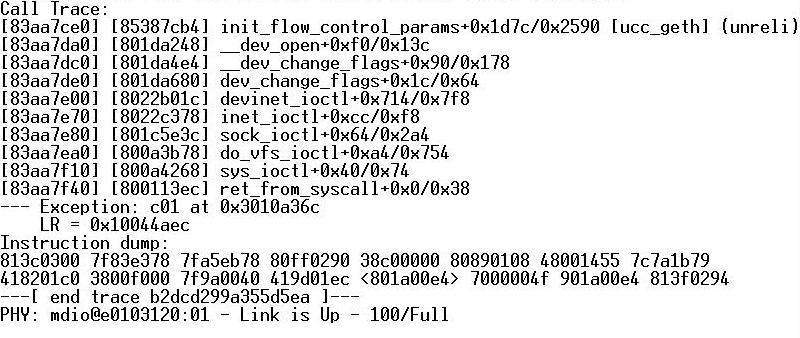

not working router os 5.6 in RB433 & RB333, not boot properly , display errors when connect on Console
What kind of errors? Please be more specific.
snap is attached for the ref.
Try to reinstall RouterOS with netinstall.
it remain same , i had try with netinstall as well as serial port
There’s something wrong with that unit, not with 5.6 on an RB433 specifically:

agreed , but i have 50+ board of 333 and all are giving same error,
also note that the same board is working fing if install 4.x
do you have some wireless card inside the router?
Does the baord boot up if you don’t have any wireless cards?
What bios/firmware version does the board has? Try to upgrade it before netinstalling.
first i had checked with wireless card , 7 got the error , after removing card it work, one more i observed is bootloader ,
if bootloader is equal or higher than 2.23 it does not giving any error , but in 2.18 it gives you error as mention above image

What wireless card are you using? Does problem occurs on RB333 without any Wlan card? Is problem solved by upgrading firmware on RB433?
thanks buddy, problem resolved
