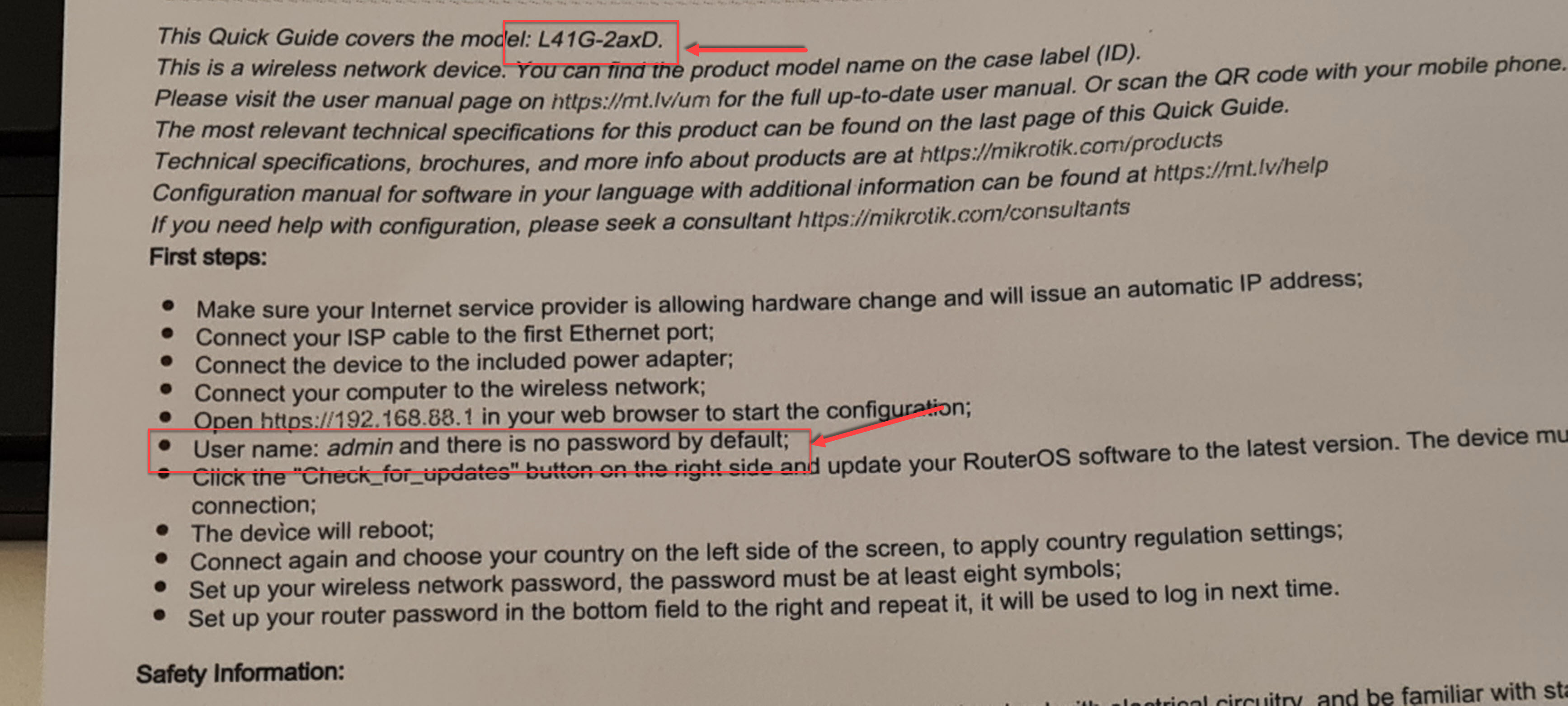

What’s that second copy ? Never seen it. Not on AC3, not on AX3, not on AX2.
As a matter of fact, just happen to have AX Lite lying here next to me on my desk with the box it came in.
The quick guide paper says there is “no default password” ?!?!
But I know there is. I had to get it from the sticker. That same sticker which has plenty of space to make the font larger.
Oddly enough: the quick guide on the product page DOES mention that on some models there is a password on the label.
Not on the leaflet which was in the box.
BTW 2 steps before the section I highlighted is already a first problem. You can’t connect to the wireless network without a password.
So somewhere there is a leak in that documentation quality assurance process …
