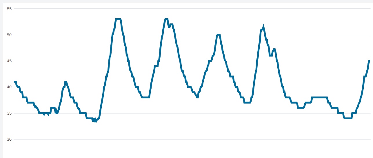

Here you see the reported temperature from my 750Gv3
Its up in the attic, so when sun is shining, temperature goes up.
Measured using MikroTik for Splunk:
http://forum.mikrotik.com/t/tool-using-splunk-to-analyse-mikrotik-logs-3-3-graphing-everything/121810/1

I see that the maximum temperature in your (nice) graph is 55C, in my situation the maximum temperature is 65C - a 10C difference.

I have one day with 66 degree, so have been up in the same range.
