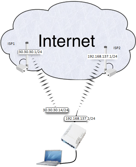

Topology:

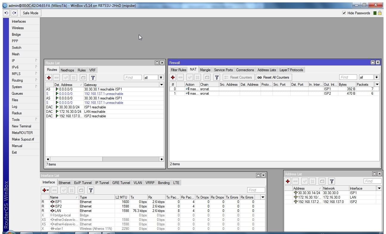

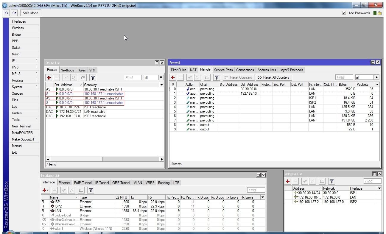

Address, NAT, Mangle, Route List:
Next we can see the ISP2 getting unreachable for some reason

Perhaps the check gateway is failing because of routing marks…
/ ip route
add dst-address=0.0.0.0/0 gateway=30.30.30.1 routing-mark=to_ISP1 check-gateway=ping
add dst-address=0.0.0.0/0 gateway=192.168.137.1 routing-mark=to_ISP2 check-gateway=ping
add dst-address=0.0.0.0/0 gateway=30.30.30.1 distance=1 check-gateway=ping
add dst-address=0.0.0.0/0 gateway=192.168.137.1 distance=2 check-gateway=ping
This is the routing table in the example shown -
Perhaps add the WAN networks to the various routing tables:
/ ip route
add dst-address=30.30.30.0/24 gateway=ISP1 routing-mark=to_ISP1
add dst-address=192.178.137.0/24 gateway=ISP2 routing-mark=to_ISP1
add dst-address=30.30.30.0/24 gateway=ISP1 routing-mark=to_ISP2
add dst-address=192.178.137.0/24 gateway=ISP2 routing-mark=to_ISP2
This essentially makes the direct ISP wan networks available to all routing tables.
So if a LAN client (or the Mikrotik if its outbound packets get mangled and route-marked) can ping either gateway directly and PCC won’t matter.
Try this and see if it flies.
