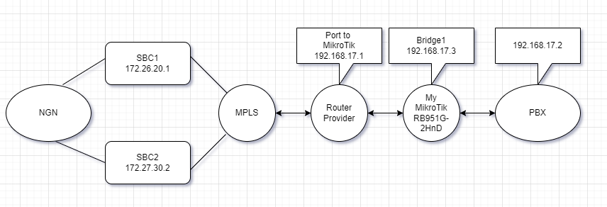

I can’t ping from my PBX - Debian 9 and connect to SBC’s servers through our Mikrotik but from the router I can ping and I have a response from the SBC’s servers.
On IP → Firewall → Connections I can see SBC’s src. address to PBX dst. address but the inverse connectivity from PBX to SBC’s address is missing.
Bridge 1 has IP 192.168.17.3 and has ping to all in 192.168.17/29 and to SBC’s servers 172.26.20.1 and 172.27.30.2.
but PBX is with IP 192.168.17.2 and has a ping only to IP 192.168.17/29 but not to the SBC’s servers 172.26.20.1 and 172.27.30.2.
In attachment is my the scheme.
And my settings are very few because the network is a closed type with direct optical connectivity to the provider.

How can solve this problem?
So basically Mikrotik is used as bridge/switch between PBX and provider’s router. Or is it? Is PBX properly configured with route towards SBCs (either default route or specific routes, using provider router’s address as gateway?
If you connect PBX directly to provider’s router, is the connectivity with SBCs OK then?
Your config is hard to read due to many disabled config items … and if you decide to enable that bridge/vlan config line, it’s bound to give you problems on ether1 (under bridge/port it is untagged (it has pvid set) while under bridge/vlan it’s in the tagged port list).
