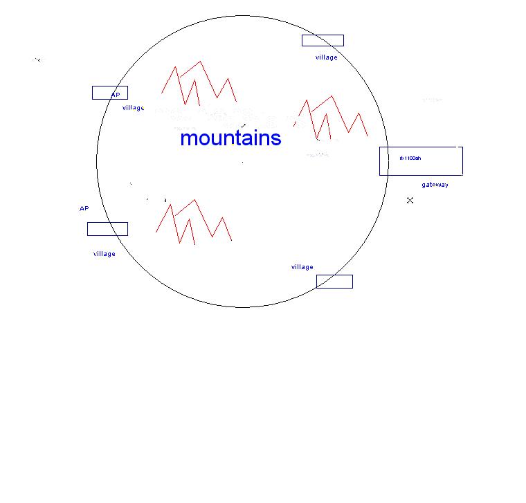

Routing a Ring Network with Diversity & Redundancy
Can anyone offer some simple suggestions for routing the attached scenario. At present I have a fully routed network and in the next few days I am about to close the “ring” by completing the last hop from 1 village across to another.
From then on, each village (AP) will have a choice of routes, should any route break then the traffic would go the other way.
But I want to go one stage further and split the load between each half of the loop, (diversity) and also if 1 half breaks, then the traffic continues to flow through the other surviving half (redundancy).
It looks simple when it comes to splitting traffic between 2 wireless links as I have suggested to someone else in a similar scenario.
But is there a routing policy out there that would make both these tasks easy??
Simon
Use OSPF and configure proper path costs, and each router should calculate proper routes for itself.
If the ring breaks, OSPF will kick in again and everything will still work.
Dynamic routing is the way to go.
Hi Tom
Thanks for the suggestion, but am I missing something, I was looking for my bread buttered on both top and bottom.
Will your suggestion also split the load ? ie say 20Mb in one direction and 20Mb in other.
Simon
Sending traffic 2 ways in a ring topology to one destination is problematic. Packets can arrive out of order since conditions on one side of the ring can be different then on the other side. Also, how are you going to split the traffic? 50% one way, 50% the opposite way? What if one of the paths is already at full load?
Sub-packet load balancing should not be used, packet based load balancing doesnt make sense either (ECMP), so you would need to send traffic through different paths around the ring based on PCC (PCC src-address:dst-address probably best)
Implementing all that on top of dynamic routing (OSPF) … I dont think its possible. But OSPF will properly split the traffic depending on which path is the closest for different destinations.
You could implement load balancing with failover based on PCC as well; but that would all have to be done manually on each node in the ring. It would provide failover, routing and load-balancing, but it still doesnt solve the issue of how to know how much traffic to send one direction in the ring, and how much the other direction.
You could go crazy and do it all using MPLS TE tunnels, but I dont know enough about MPLS and TE on this scale to help.
Hi Tom, I agree with most of what you say..
The current backbone is adequate for my input. However I am sure that having extra capacity available by halving the load could do no harm.
It doesnt have to be exactly 50/50, I would happily settle for 60/40..
It just seems such a waste to have a functioning circuit sitting there redundant.
Making a “failover” is so simple, with possibly a dozen methods.
I was thinking of alternate “new connection marks” in mangle to be used to make “route marks” and then using a script to perhaps modify those marks according to the surviving path.
Maybe I take a look at our PCC suggestion, I hadnt thought of that… I am sure someone on this forum must be using a ring type network with both diversity and redundancy.
Actually, look at the presentation in my sig, it explains something very similiar.
Still, even dividing traffic 60/40, what if the part of the ring where 40% of the traffic goes is already at full load? The problem with scripting and mangling it localy is that you simply dont know about the conditions of the other links in the network to make an informed decision in the script as to where to send what part of traffic.
Thats why I suggested MPLS TE, because that would solve that.

If its a fully routed ring and no NAT is used, use OSPF. It will still provide partial load distribution, since the traffic is always going to take the shortest route around the ring.
When multiple sessions to multiple destinations in the ring are open, they can go different paths, depending on what their distance is to the origin of the connection.
OSPF will also deal with all redundancy and routing issues for you automatically. I think that is the best solution if you dont want to do MPLS TE.
I can even imagine setup with static routing only. Therefore you can use masquerading (if needed) and loadbalancing with PCC at village AP stations without complications. I imagine it this way:
-prepare two L2 semi-rings (bridged vlans or bridged eoip tunnels or switched vlans or mpls solutions - simply any kind of L2 connectivity). Connect every village AP with RB1100AH double way. One way in first L2 connection clockwise. Second way in second L2 connection anticlockwise,
-connect every semi-ring with RB1100AH only one way. First semi-ring from north (clockwise), the second semi-ring from south (anticlockwise),
-prepare two /29 subnets. One subnet for every L2 semi-ring. Add one ip for every AP in every semi-ring. Add one ip for RB1100AH in every semi-ring.
Suppose these are suggested subnets for semi-rings:
10.0.0.0/29
10.0.0.8/29
Suppose these are subnets used behind village AP’s:
192.168.0.0/24
192.168.1.0/24
192.168.2.0/24
192.168.3.0/24
Suppose L2 rings are connected to AP’s and RB1100AH via bridge interfaces:
bridge1
bridge2
Suppose you put addresses like this:
RB1100AH:
    add address=10.0.0.6/29 interface=bridge1
    add address=10.0.0.14/29 interface=bridge2
1 AP:
    add address=10.0.0.1/29 interface=bridge1
    add address=10.0.0.9/29 interface=bridge2
2 AP:
    add address=10.0.0.2/29 interface=bridge1
    add address=10.0.0.10/29 interface=bridge2
And so on…
Now you can use simple trick with static routing (but still adapting second gateway in case of connection problems):
1 AP, 2 AP, 3 AP, 4 AP:
    add gateway=10.0.0.6 check-gateway=arp distance=1
    add gateway=10.0.0.14 check-gateway=arp distance=2
RB1100AH:
    add dst-address=192.168.0.0/24 gateway=10.0.0.1 check-gateway=arp distance=1
    add dst-address=192.168.1.0/24 gateway=10.0.0.2 check-gateway=arp distance=1
    add dst-address=192.168.2.0/24 gateway=10.0.0.3 check-gateway=arp distance=2
    add dst-address=192.168.3.0/24 gateway=10.0.0.4 check-gateway=arp distance=2
    add dst-address=192.168.0.0/24 gateway=10.0.0.9 check-gateway=arp distance=2
    add dst-address=192.168.1.0/24 gateway=10.0.0.10 check-gateway=arp distance=2
    add dst-address=192.168.2.0/24 gateway=10.0.0.11 check-gateway=arp distance=1
    add dst-address=192.168.3.0/24 gateway=10.0.0.12 check-gateway=arp distance=1
You can play with distance parameter on every AP and on RB1100.
You can use two way static routing (loadbalancing) like this:
    add dst-address=192.168.0.0/24 gateway=10.0.0.1,10.0.0.9 check-gateway=arp distance=1
So a little bit advanced STATIC routing is sometimes better solution than dynamic routing. I do think so. :slight_smile:
The only missing functionality with this kind of setup is BFD protocol. You can use BFD with dynamic routing only. The question is to Mikrotik. Is it possible to implement BFD for static routes?

Using it with “gateway=10.0.0.1,10.0.0.9” is ECMP (Equal Cost Multi Path). I already mentioned it in the posts above, also describing why its a bad idea.
Imagine that your ring looks like this:
1---2---3
4       5
6---7---8
Now imagine something behind node 1 is trying to communicate with something behind node 2. Half traffic will go 1 → 2. Other half traffic will got 1->4->6-> etc ->3->2. Obviously this is bad. Packets will arrive out of sequence. You dont know if links 6->7 is already at full capacity, etc. I personally think ECMP would break more then help anything.
Also, with OSPF, redundancy and automatic routing changes are handled much better then with any static config. You can indeed use BFD with OSPF if you need fast timers but no BFD with static routes.
I only show one of possible solutions. I do not say: static way (my way) is better than dynamic. :slight_smile: I use described static routing in few places and it works without any problems. In biggest case I route this way about 1.5 Gbps of traffic from few thousands of customers.
If you mean: “bad idea because of unordered packets flow…” it is simply not true. In ECMP packets are sorted per connection and in one connection they use only one gateway. So no chance to unordered packets.
Again not true. No packets out of sequence in this solution. It is, of course, possible than you will have asymetric routing. But not unordered packets. Asymetric routing this case means: packets in up direction use not the same way than packets in down direction. But this situation is not as wrong as you suggest. For instance in global BGP routing you have many cases when routing is everyday asymetric.
It is possible to add additional static routes to counteract routing between segments through RB1100. But I omit that for simplicity.
And again: OSPF solution is very good for discussed case! I don’t deny that. OK? :wink:
I only show possible alternative.
You are right. For some reason I remembered ECMP is packet-based. Did some reasearch, and you are entirelly right, its src-dst address based (route decisions are cached.)
http://wiki.mikrotik.com/wiki/Manual:IP/Route#Multipath_.28ECMP.29_routes
How to detect network outages farther then one hop tho if all routing is static tho? Also, since this is wireless and all traffic from all nodes is constantly going both ways around the ring, dont you think it would actually cause worse performance then if the traffic always took the shortest route? (considering a scenario that all nodes are transfering data)
Im not saying OSPF is the best answer either, just offering my opinions :slight_smile:
As you can see at attached picture there is no more hops than one. In layer2 you see gateway directly. So there is no need to look farther then one hop. And in this situation router automatically detects outages via arp or via ping (check-gateway=arp or check-gateway=ping). In my network I use check-gateway=arp. Routers need about 8-10 seconds to detect outage. When link returns after outage, there is no such brake.
In simplest case, when you do not use ECMP routing, there is no such problem. For instance:
-traffic from and to AP1 and AP2 you can route via bridge1
-traffic from and to AP3 and AP4 you can route via bridge2
# this is at AP1 and AP2
# this is at AP3 and AP4
    add gateway=10.0.0.6 check-gateway=arp distance=2
    add gateway=10.0.0.14 check-gateway=arp distance=1
# this is at RB1100
So effective path is shortest possible.
There is no need to use ECMP. This is only possibility if you want or need to loadbalance traffic more precise than suggested erlier. It is not necessary.
And finaly, for precision… this is STATIC config. You can test, observe and manually configure which link should use every AP node. It adapts to link outages, but does not automatically adapt to link congestions.
