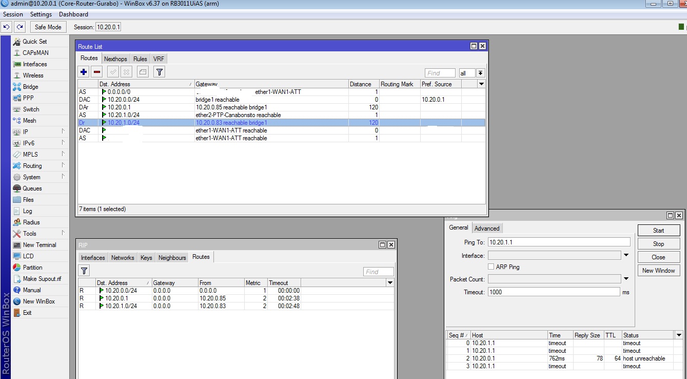

I attached router 1 config screen

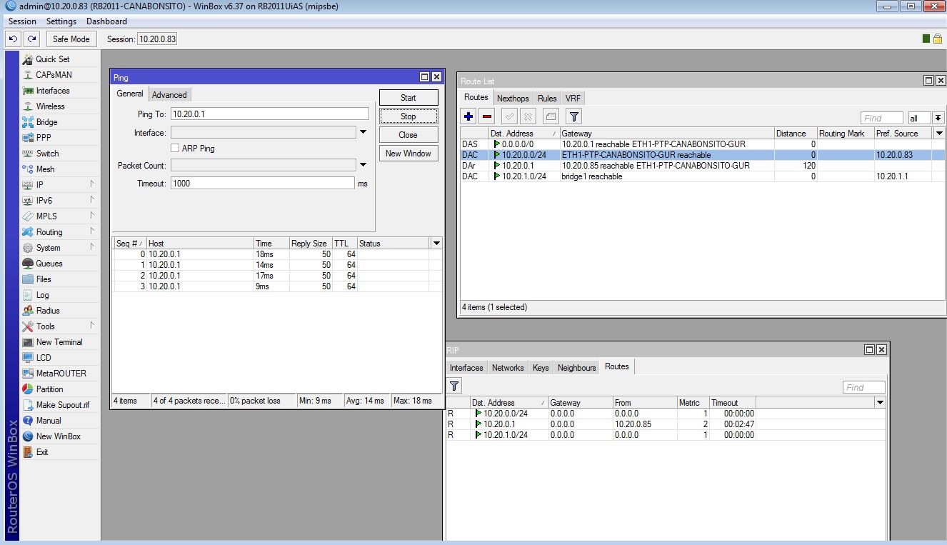

I attached Router 2
On router 1, isn’t your static route incorrect? The one going to dst address 10.20.1.0/24. It is set for gateway ether2-PTP-Canabonsito but I think you want the gateway there to be 10.20.0.83 instead. It needs to know the next hop address and you are not supplying it.
Yeap that did the trick!
