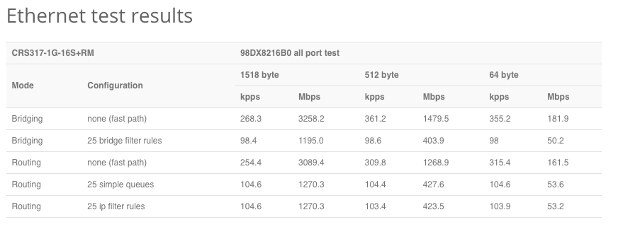

i would want know your exprience performance with crs mode routing bgp/mpsl for throughputwiht 300-400mbps with CRS317-1G-16S+RM
I have yet to test this device, but I doubt it.
CRS is a programmable Switch, but CPU power is not suitable for routing (software) that bandwidth, acccording to its specs:
Best bet for that duty if budget is no object: CCR or RB1100AH.
Low Budget: possibly suitable with some optimization: Hex or RB3011.
