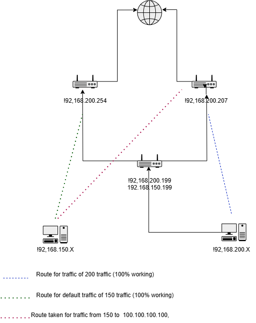

The issue here is why there no response getting to the client, I’ve attached a quick diagram of what I’m trying to do

Currently traffic to the 100.100.100.100 on vlans 100 and 200 work perfectly, at the moment 150 only seems to have 1 way, traffic received by the remote server but the responses are lost, I believe the issue is something on the Selector, is there any logging I can do on the routers to confirm the responses from 100.100.100.100 are coming back into my network and where they are being lost.
I’ve also confirmed that the Vlan Gateway can bing the clients on VLan 150
