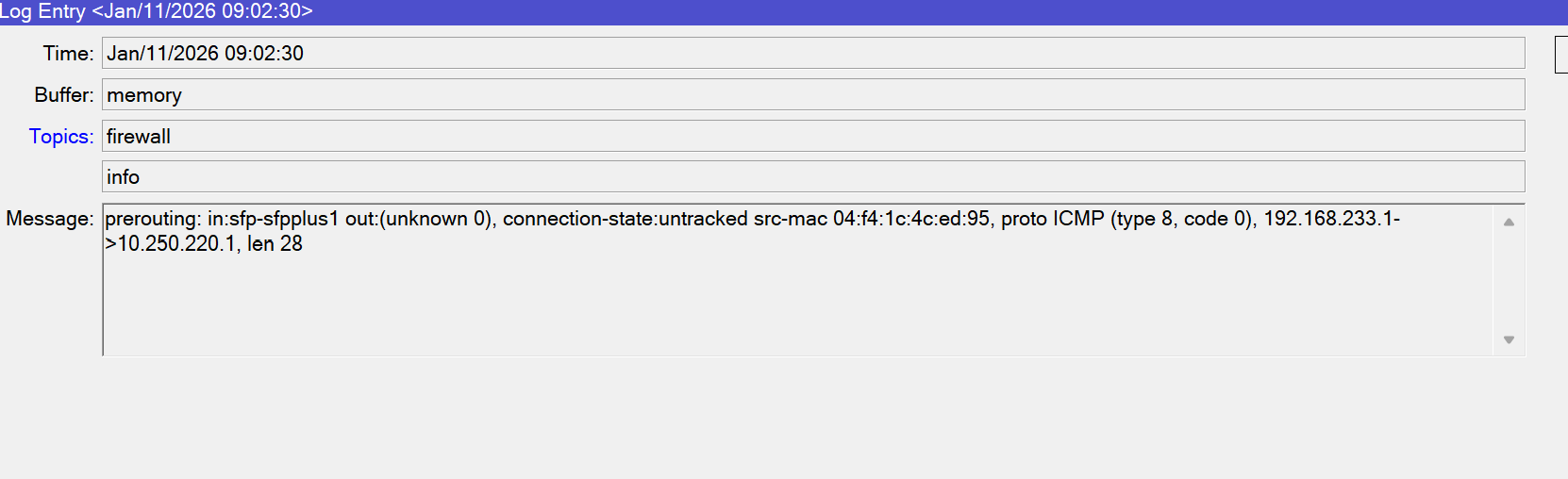

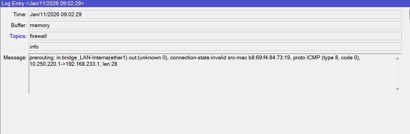

4.- We created a RAW rule to avoid any conflict that might occur with the other firewall rules, and the log generates these results. See image_1, image_2.

Depending on particular setup, there might be a routing triangle between those 3 routers: packet from network a is passing router A then main router then router B and then towards target network x. If packet in reverse direction skips main router (because router B somehow knows that router A is gateway towards subnet a), then firewall (connection tracking machinery in particular) on main router gets out of sync because some packets are bypassing it.
One test to see if this is indeed the problem would be to add raw firewall rule with action "notrack" for traffic between subnets off routers A and B (and have a firewall filter rule which allows untracked packets as one of early rules). More permanent (and "cheaper" for CPUs on routers) solution would be to add appropriate routes on routers A and B.
If you actually want to force traffic between those subnets through main router for some reason, then you'll have to look into routing settings on all 3 routers ... or actually have connections between main router and each of routers A and B in different L2/L3 subnet so that direct path between router A and router B won't be available.
Hi mkx, thanks for replying. Here's some more information from the RAW rule log:
error_10.250.222.0 prerouting: in:sfp-sfpplus1 out:(unknown 0), connection-state:invalid src-mac 04:f4:1c:4c:ed:95, proto ICMP (type 8, code 0), 192.168.233.19->10.250.222.161, len 84
