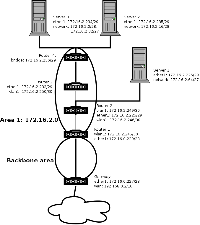

I’m trying to summarize routes from a nssa area to the backbone, through an ABR.
Area1 (nssa) has only network 172.16.2.0/24 and subnets are assigned from different routers
My problem is that I don’t know why the ABR (Router 1) isn’t announcing just 172.16.2.0/24, but also some two routes, as 172.16.2.64/27 and 172.16.2.0/26 (correctly summarized by Router 4, using /routing filter).
Am I wrong because all routers must have the same LSDB (link state database) ? But this is only for routers in the same area, or not ?
This is the network diagram:
And these are the configurations:
Router 4:

routing filters can filter only external routes, otherwie it will break OSPF database.
Ok.
But, why are /30 and 172.16.2.232/29 summarized ? Aren’t they internal routes ? Even 172.16.2.224/29 isn’t propagated, if Router 2 has this net enabled in /routing ospf network
Everything is correct:
172.16.2.232/29
172.16.2.244/30
172.16.2.248/30
are added to OSPF networks, so those routes are summarized by area range.
other routes 172.16.2.xx/xx are external and are accepted by routing filter on router1 so they will be wisible on gateway router.
I think I understand.
routing filter does its job only on external routes matching chain “ospf-out”, is it right ?
So, is adding server 2 & 3 to the ospf area the only way to summarize their routes ?
