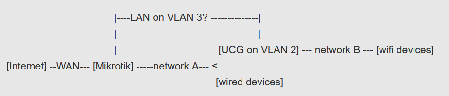

Let’s try:
how would I set LAN up so that it doesn’t make a mess? Of course the two cables to the UCG would be on different switch (one on eth1-5, the other on eth 6-10)
In the current setup (without the LAN cable) network B can access network A, A can’t access B because UCG is blocking all incoming traffic on WAN port, and this can’t be changed.
