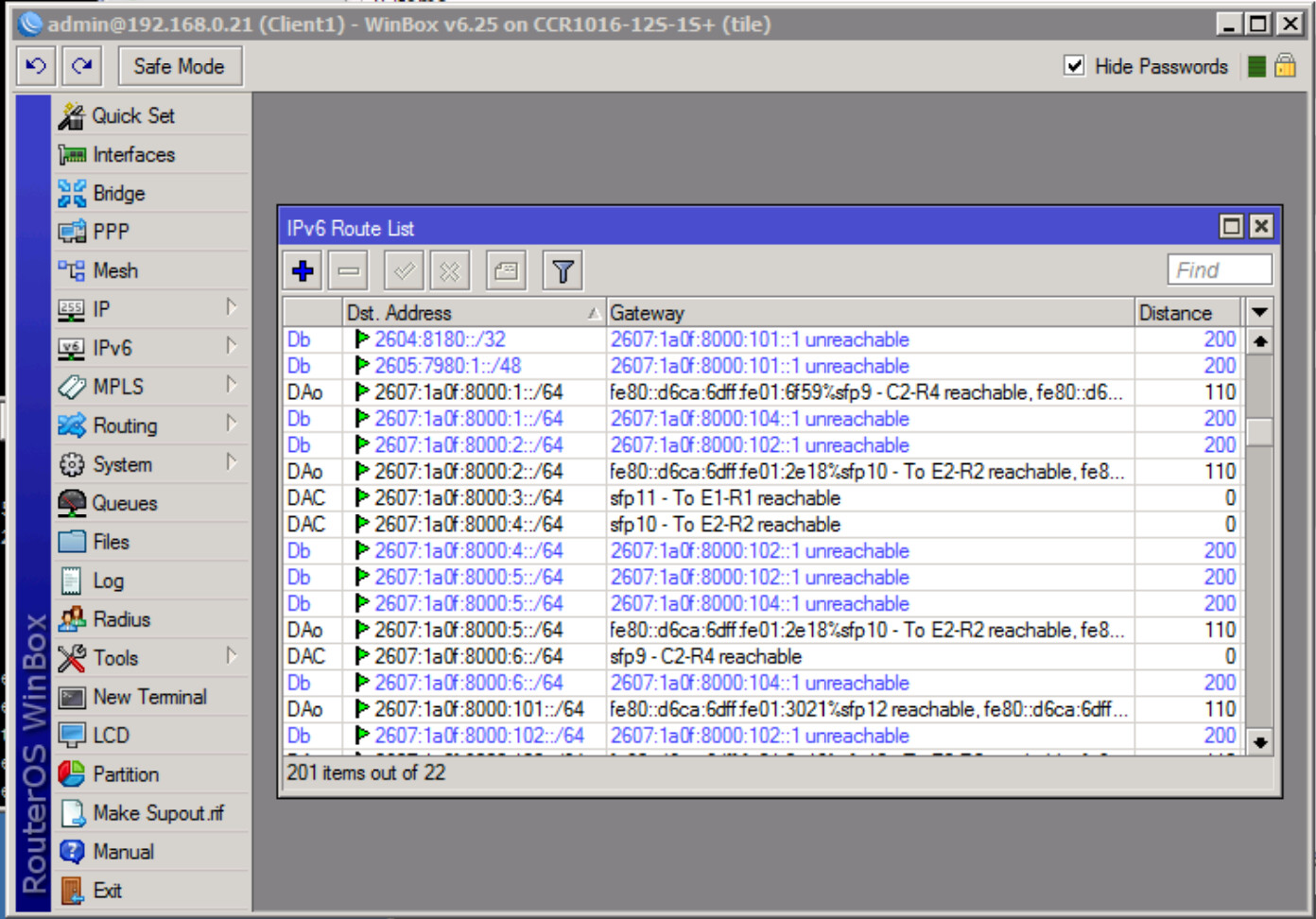

I’ve set up my ipv6 space the same way, and I’m having an issue. Which maybe is related to the previous issue.
When I look at the routes R3 (or R2 or R4) receives from R1, they all show like this. All incoming ipv6 BGP routes show as unreachable, using 2607:1a0f:8000:101::1 as the gateway.
The thing is, you can see in that image that the ip is pingable. The OSPF route is installed a few lines below, and shows as reachable. Likewise if I just do a ping to that gateway address (2607:1a0f:8000:101::1), it pings just fine. But all the BGP routes coming in show as unreachable using that same address as the gateway.
This is a problem for me because I need to turn around and announce that whole routing table in another BGP session. And as all the routes show as unreachable the BGP session doesn’t announce them.
