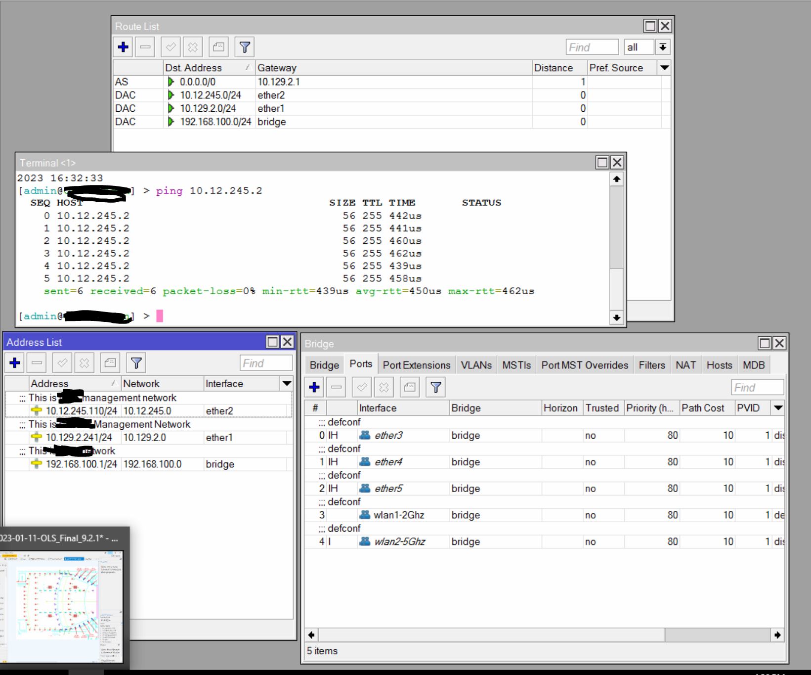

I’m sure this is a basic question but I can’t figure out this by myself.
I have an hAP ac3 and the following network configuration
I need to be able to access BOTH networks 1 and 2 when I am on WiFi. The router has always worked connecting WiFi to Network 1 and internet. Today I added Network 2 on ETH2 but I cannot access the devices on Network 2 when on WiFi.
I can ping them though, from the terminal of the router itself.
What am I missing here?
Thank you!
Tony

The Mikrotik will route packets from 192.168.100.x to 10.12.245.x, but those devices have no idea where to reply to unless they, or their default gateway device, have a static route of 192.168.100.0/24 via 10.12.245.110. The simplest fix is to NAT traffic from 192.168.100.x so it appears to originate from 10.12.245.110 with an additional NAT rule:
add action=masquerade chain=srcnat ipsec-policy=out,none out-interface-list=222
I thought something similar but I thought that since the Mikrotik is actually on the network with 10.12.245.110, it would be enough. I was missing the NAT rule, thank you!!
I’ve just tried and it seems to be working, thank you SO MUCH for your time, I do appreciate that.
