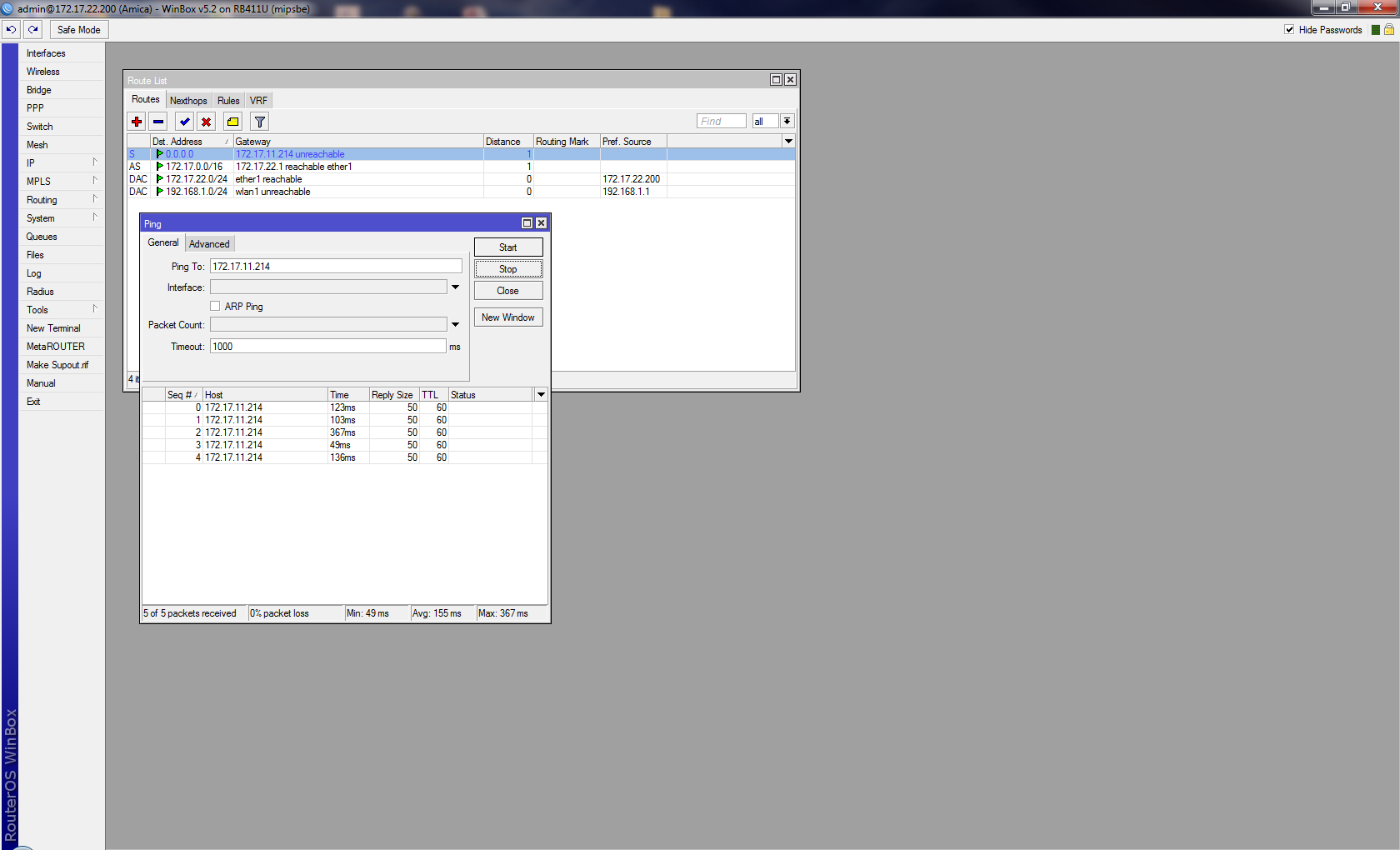

I have a routed network, with a rb450 and userman sitting on the 11 vlan @ 192.168.11.214, one hotspot sitting on the same vlan at 192.168.11.250, one hotspot sitting on the 192.168.22.250 vlan etc. Radius authentication is working fine but the moment I enter a second gateway on the 22.250 hotspot to route 0.0.0.0/0 to 192.168.11.214 it says unreacable, I can however ping this interface and access anything else on my routed network. Where am I going wrong, I still have to add another 6 hotspots to the routed network on different vlan’s.

add address=172.17.22.200/24 comment=“WLan connection to SZ” disabled=no interface=ether1 network=172.17.22.0
add address=192.168.1.1/24 disabled=no interface=wlan1 network=192.168.1.0
add disabled=no distance=1 dst-address=0.0.0.0/0 gateway=172.17.11.214 scope=30 target-scope=10
add disabled=no distance=1 dst-address=172.17.0.0/16 gateway=172.17.22.1 scope=30 target-scope=10
add disabled=no distance=1 dst-address=172.17.11.0/24 gateway=ether1 scope=30 target-scope=10

My route 172.17.0.0/16 gateway points to all 172.17 traffick, and it works but I want 0.0.0.0 to route to 172.17.11.214. I can ping this interface from the MT. But
the route 0.0.0.0/24 gateway 172.17.11.214 says unreacable.
The top route is unreachable, eeven if I change the scope of it.

As I said, I can ping the 172.17.11.214 gateway from the MT, but the route says unreachable.

I have a 172.17.0.0/16 network, my MT is 172.17.22.200 gateway 172.17.22.1, My ADSl gateway is 172.17.11.214. I can ping from both sides, (forget my wlan interface and ip.) I now want my MT to route all unknown traffick out the gateway 172.17.11.214. (Can ping it from both sides) but this route shows up as unknown. So in short I have two gateways 1. 172.17.0.0/16 gateway 172.17.22.1 2. (ether1) 0.0.0.0/0 gateway 172.17.11.214. (unknown interface)
My dillema is getting unknown traffick to use the 172.17.11.214 gateway
I don’t see the interface that the ADSL subnet is connected to on this router. If it is connected to this router, then you need to assign that ip/subnet (172.17.11.x/24) to that interface. Maybe ether2?
Otherwise, if the ADSL modem is connected to another interface on the Cisco, you will need to do the gateway routing there.
The 172.17.11.214 is not attached directly to the MT
it is 172.17.22.200 → 172.17.22.1 → 172.17.11.1 → 172.17.11.214

If the 172.17.11.x/24 subnet is not assigned to this router, you CANNOT USE IT AS A GATEWAY!

You are routing to it. If the address is not 172.17.22.x/24 (ether1), or 192.168.1.x/24 (wlan1), then it sends the request through 172.17.22.1 (gateway for ether1).

The 2nd router 172.17.11.214 is on another interface. 172.17.11.1-172.17.22.1 are on the same Cisco core, and not propogating routes to the MT. So mt 172.17.22.200 is 30 km from the core 172.17.11.214 is 5 km from the core just to give you a mental picture.

As I said forget the wlan interface, leave it disabled. See the pic. Lower left corner is the MT (Amica Guesthouse) Right hand corner is the Mikrtik (Unsupported device)
I need to route from Amica to the MT right hand corner for outgoing traffick, No nat involved at this time. everything on this network can ping any other device without problems, I want the 172.17.22.200 to use the 172.17.11.214 as a nexthop router to the outside world.
That is a job for the Cisco router.
ADD: Do you understand why? Because it is the only router that has both those subnets on it. The Cisco router must decide which gateway on the Cisco router you should use.
