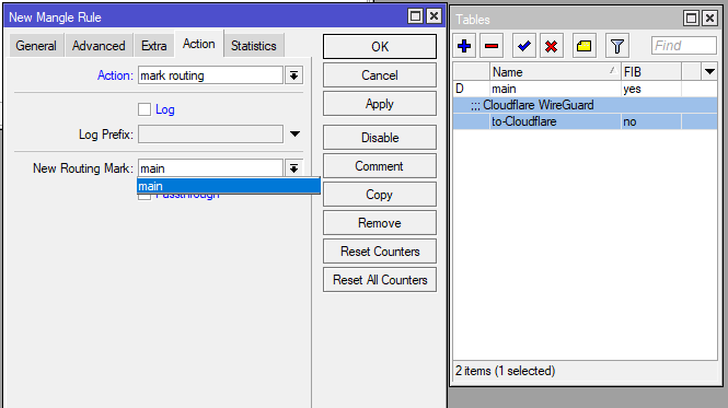

But when I try to add mangle rules, on action “mark routing”, the ‘new routing mark’ doesn’t show the routing tables that I already add.
I’m adding routing tables on Routing → Tables, menu.
Why ? any suggestions ?
because your routing table is not marked as FIB

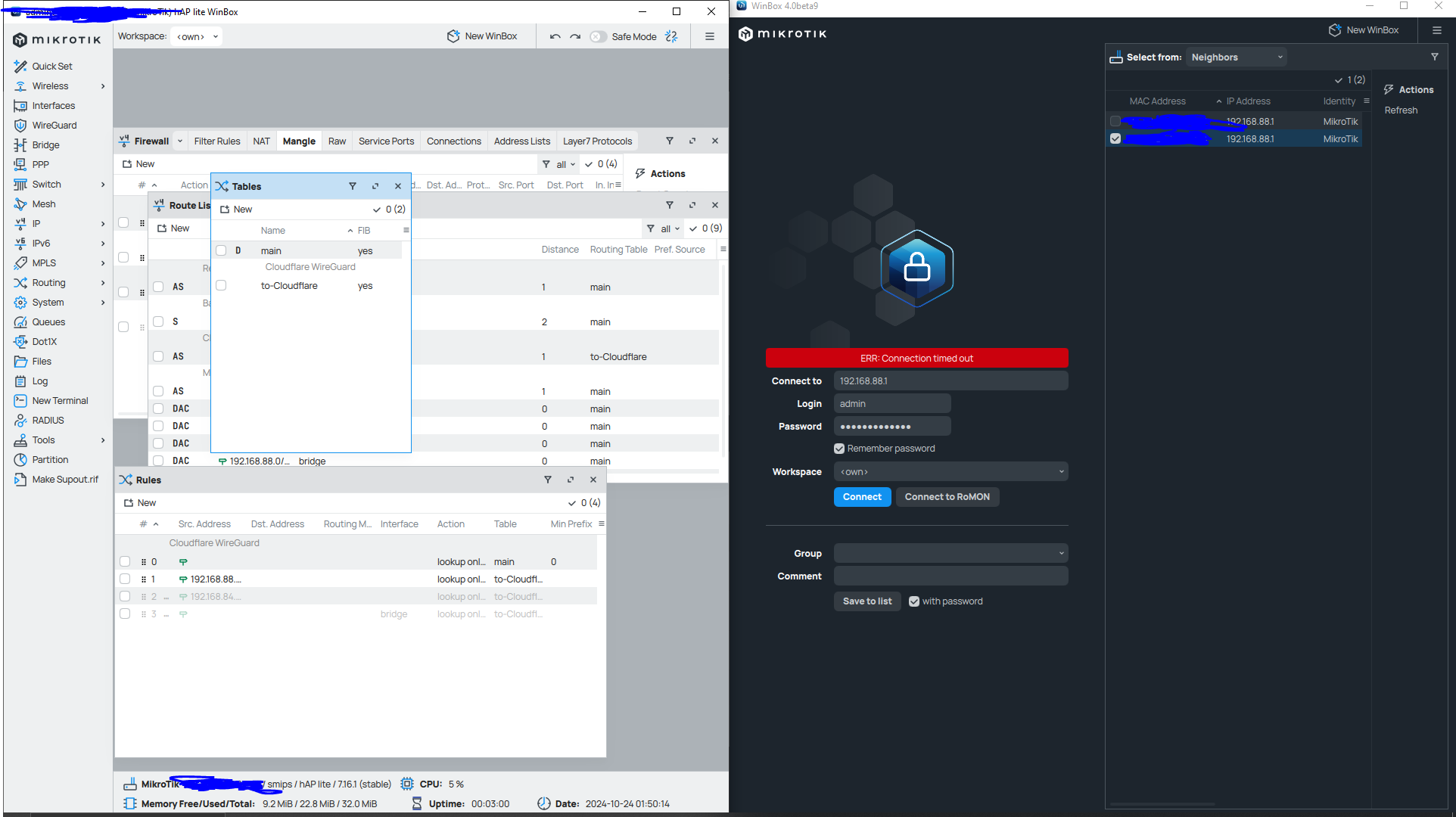

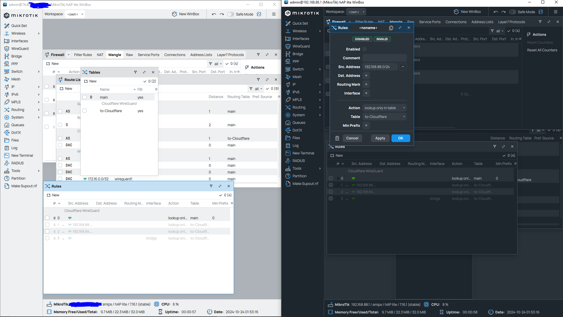

I already rebooted the router, and then the routing tables came up.
But there is more problem, I’m using recursive failover, wan 1 to my main internet, and wan 2 to my second internet as backup.
When I follow the last tutorial it
  • add mangle “chain prerouting, src. address range of default-dhcp, action mark-routing, new routing mark to-Cloudflare”
  • add routes that “Dst. Address 0.0.0.0/0 to gateway wireguard1, and routing table to-Cloudflare”,
    It works, and my internet connection follows the wireguard VPN, but after apply route my winbox disconnected from my routerboard and can’t connect via IP, only via mac address, any suggestion ?

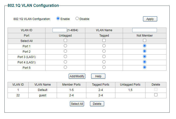

Firstly, you state ether2 is a WAN port and yet you have ether2 on the bridge… It should be removed.
It also states that you ahve ether3, and ether4 on the bridge but earlier you have them bonded and you also have the bond on the bridge.
Im no expert but one does not put all of them on the bridge and I would hazard a guess just the bond.
Now you have the bonding on the bridge and bridge doing dhcp hands out iP addresses for .88 subnet.
Why do you have the bond associated with vlan22 on the single interface bridge vlan rule??

Remove current mangle rule…
Add routing rule instead.
add min-prefix=0 action=lookup-only-in-table table=main
add src-address=192.168.88.0/24 lookup-only-in-table table=to-Cloudflare
NEED to adjust Routes accordingly.
After I add routing rules, winbox can’t connect to router using IP address, why ?
I think my question is out of this topic, so I made the new topic for my questions… :slight_smile: https://forum.mikrotik.com/viewtopic.php?t=212011&sid=d60011cf12d294c3b04ebca9c2ab3ac0
