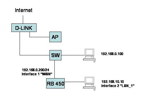

My structure looks like in attached (applogies for the quality - I made it in a rush)
rgs Pilgrim

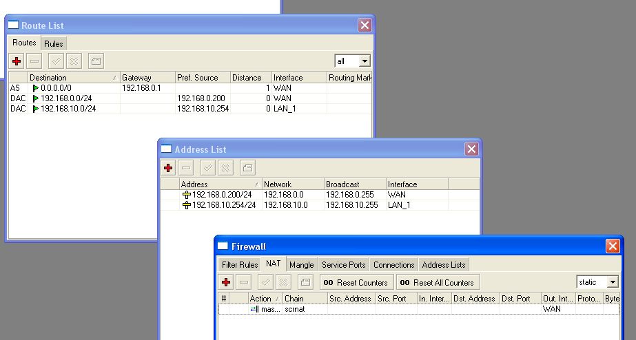

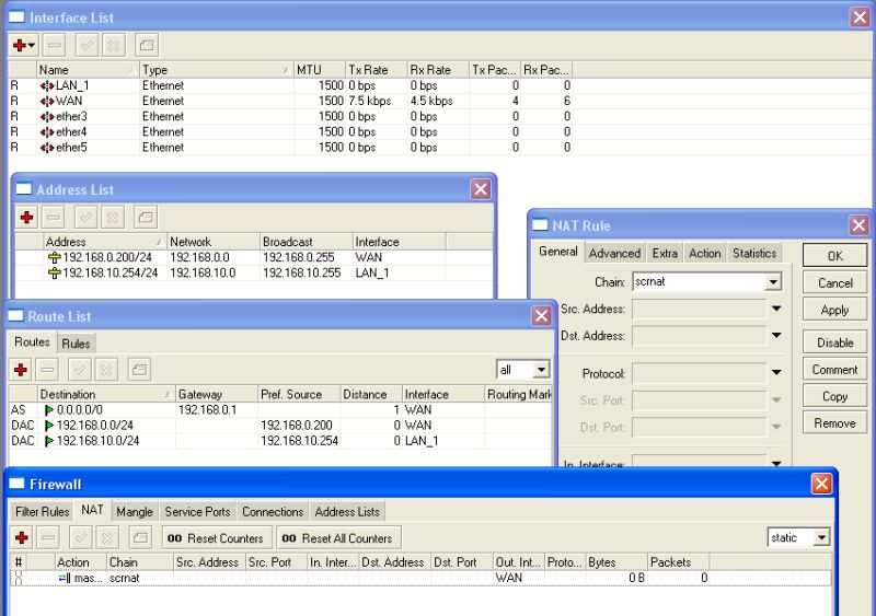

I winbox I just discovered another thing. The X we talked about before I could remove by cliking on # above and it now looks like this.
rgs Pilgrim
All is well if your computer is in port 1 and the D-Link is in port 2, and th rest are empty. That is what your WinBox Interface List says above ^

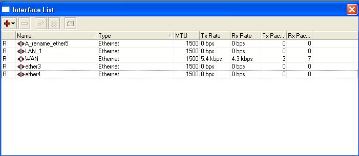

I think it is just looks this way in because in my winbox the list is sorted in alphabetic order. I tried to rename ether 5 to A_renmae_ether 5 and it jumped from bottom to the top of the list. It attached I have disconnected all cables except the cable from the D-Link in port 1 (interface named “WAN”) and it is the only on active.
Just to be sure I tried to switch around the cables D-link in port 2 and pc in port 1. I didn’t help and I am also not able to ping the mikrotik router from 192.168.0.100 anymore.
The problem must be somewhere around your first assumption concerning the scrnat. I am not sure it is active.
