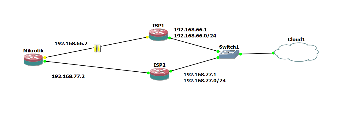

I am using GNS3 to lab Mikrotik with failover network for a project I am working on. My goal is to make 192.168.66.1 the primary WAN and fail over to 192.168.77.1 if the primary WAN is down. My method of checking if the primary WAN is down is adding a static route to 8.8.8.8 and using a ping check (recursive, as described here: https://www.prinmath.com/ham/mikrotik-failover.htm)
The Problem: When I suspend the connection from ‘Mikrotik’ to ISP1 (192.168.66.1), I would expect the ping to 8.8.8.8 to stop working. However, it switches over and continues pinging on 192.168.77.1 gateway. I would expect the ping to timeout because I have it set to route over ISP1 exclusively, right? Anyone see anything wrong with this? Could it be a GNS3 issue or a mistake in my network topology outside of the Mikrotiks?

You need to firewall additionally block access to 8.8.8.8 through all other interfaces except the required ether1.
When you disable the ether1 interface, all routes associated with it are disabled.
As a test you can cut the connection between ISP1 and Switch1, everything will work as you wanted.
OMG that was it. The route was getting disabled because I was suspending or unplugging the cable, which disabled ether1. I’m not sure how I was supposed to know this but I am glad I know it now.
