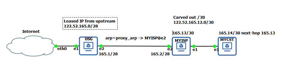

Please see this illustration if you carved out /30 from original allocated /28 and you enable proxy arp on your router (MYISP) facing your upstream (USG) it should work your customer (MYCST) should have a public IP I hope it make sense
Since you are assigning a public/routable IP there should be no NAT involved here just make it sure in the forward chain allow to and from from that carved out subnet
Hi, thanks for the nice description… and this is actually how it is set up… only thing is taht MYCST’s traffic end up as 165.2/28 traffic on the internet… I guess this is src-nat going on? I only have one src-nat rule which is the default masquerade set on the WAN interface. So just to be clear, if I create a forward rule with the src-addr. that allows 165.14 to any destination (none set) that should make sure no NAT is going on?

Don’t perform any NAT because it’s routable public IP then it should work so whatever IP you end up assigning to the customer when the customer use myipaddress.net they should be able to see their assigned IP /30 in my example it should be 165.14 they should not see any other IP other than 165.14 if they do indeed see other IP (165.2/28) as you describe then check your NAT rule on your router ensure that src-address from the carved out /30 is not included on your NAT rule. if you omit the src-address then that’s your culprit
/ip/firewall/nat/add chain=srcnat src-address=!122.52.165.14/32 action=src-nat to-addresses=122.52.165.2
Try this you can try other variations and yes indeed GNS3/Eve-NG is very valuable tool and non optional :slight_smile:
