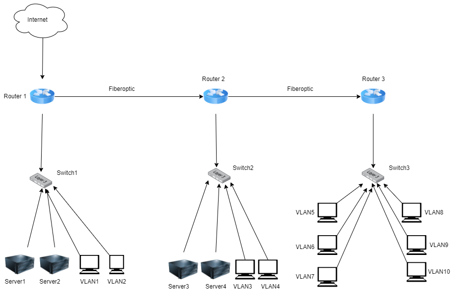

Hello ,
i have the following senario in the pic,
we had this senario already connected in every site with vpn and working well as every site has own internet connection.
now we connected all site with fiberoptic and that why we would like to change to route over lan not wan.
vlan 3 , 4 , 5 , 6 , 7 have connection to server 3 and 4 only
vlan 1, 2 , 8, 9 , 10 have connection to server 1 and 2 only
router 3 dhcp server for vlans 5 , 6, 7, 8, 9, 10 .
how to setup vlans trunk on routers while its configured as router not as a switch here is where i need you help.
any help where to start is appreciated ..
sorry for my bad englich im german !!:smiley:
best regard
Your diagram shows only one internet connection to the first router…
What is connecting each router to each other???
I think as is the description of the OP, he forgot to add separate “Internet”, for each router.
Agreed, but I prefer not to make assumptions and go down wrong paths. Best to get facts and the config!!
In the meantime recommend the OP read this. ----> http://forum.mikrotik.com/t/using-routeros-to-vlan-your-network/126489/1
Hi ,
thank you all for answering my question.
well its right that we have only 1 internet connection fiberoptic 10 Gigabit .
all routers are connected together with Fiberoptic .
old senario was that every router have its own internet and was connected over vpn (here were i can route the connection as i need )
new senario is to route the connection over fiber optic with 1 internet line!
thank you
