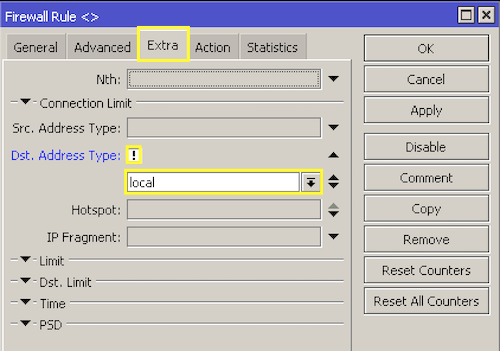

With current version, if you don’t want something use another routing table, then don’t mark routing for it. So e.g. if problem is access to router like in this example, then add dst-address-type=!local to first two rules.
Thanks but I cannot see the posiblity to add this option to rule via Winbox?
It is on the “Extra” tab. Once you open the Dst.Address Type it will show the options.
Could you show me some screenshot? I have no Dst Address Type option there under ip/route. Maybe is not available on 7.2.1? (I am trying to add this option first before the upgrade now)
Eh..but it is firewall rule. First two rules in the refered example are for /ip route , not /ip firewall
Was referring to the mangle rules in the reply from sob (in the linked post):
Sob wrote: With current version, if you don’t want something use another routing table, then don’t mark routing for it. So e.g. if problem is access to router like in > this example> , then add dst-address-type=!local to first two rules.
OK, did a try, it solves unreachability of the router itself but still issue with nonworking routing rules under Routing/Rules ?
