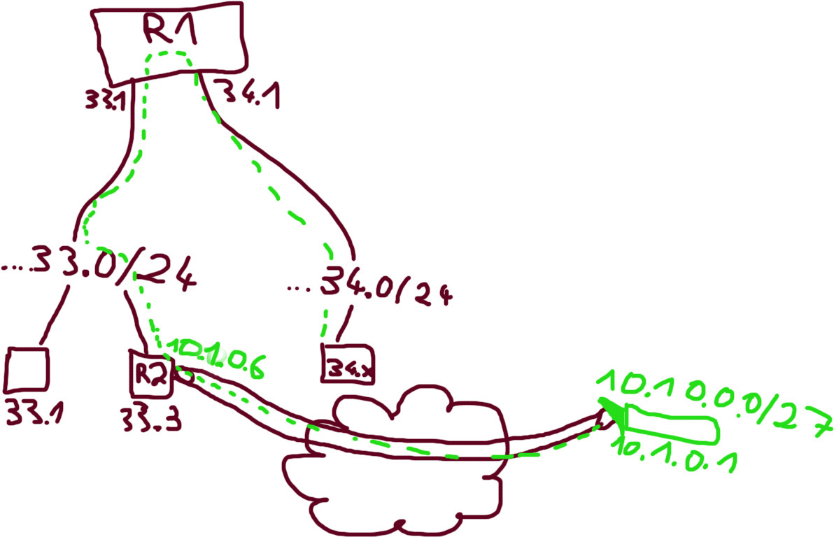

routing problem
the VPN tunnel from 33.3 to the external VPN server works - the 10.1.0.0 is from both sites of the tunnel reachable.
Which routes and NAT rules must I set on R1 and R2 that 10.1.0.6/10.1.0.1 are reachable from the 34.0 network through the 33.1 and 33.30?

Is R1 acting as a NAT for the x.x.34.0/24 network; or is it just a router that routes the traffic?
How is routing between R1 and R2 handled currently? Can devices in x.x.33.0/24 “talk” directly with devices in x.x.34.0/24 without the use of a NAT?
In my opinion, the easiest thing would be to setup OSPF on R1 and R2 and have R2 advertise the network/IPs of the tunnel and beyond to R1. That is without knowing further details in how your network is setup. You can also use static routes.
Yes, 33.0 and 34.0 are NAT routed to the gateway (33.1) but 33.0 also routed directly to 34.0 without NAT (34.0 can directly communicate with 33.0).
Or can I solve it with port forwarding, that 33.1:1080 will be routed to 33.3:1080 and this will be routed through the tunnel to 10.1.0.1:1080?
I would need the tunnel only for socks proxy uplink.
Say what?
So the gateway on R1 is the NAT for both networks? Where is your ISP connection?
If x.x.33.0/24 and x.x.34.0/24 can “talk” directly with each other without using a NAT, simply configure routing - whether it be static or dynamic.
You’re trying to make this way more complicated than it needs to be. Also, without knowing how your network is configured, you could make things worse.
ISP is on 11.0 on another port of R1.
Ok, I will try it with static routes.
UPDATE_1: On R1 I set following route: 10.1.0.0/29 via 192.168.33.3 (now from 34.0 10.1.0.6 is reachable).
But from 34.0 I cannot ping 10.1.0.1 (only 10.1.0.6 is reachable).
UPDATE_2: Ok, now it runs, I forgot the two forwarding rules on R2. :wink:
Thanks. :slight_smile:
