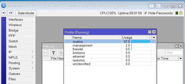

To me it is exactly the same with a RB433AH, CPU 100% of the routing, and without flowing traffic. And I do not use any routing or BGP / OSPF or VPLS. All basic configuration, I have version 5.14, and also happens to me, could be is the problem of new boards (hardware). Have if it is the solution. Thanks.
Look at the image.
I can immediatelly recommend two things, ibermi. Please upgrade RouterOS to v5.17, and also try to not use MAC address when connecting to the router. Use IP address, it’s much faster and more stable.

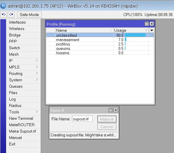

I tried doing a supout.rf, but no way has the CPU at 100%, and is unable to create it, leave 30 minutes more, but could not.
