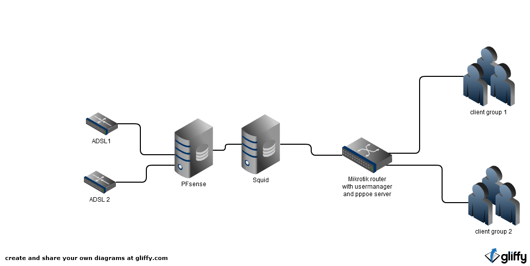

this is my network layout. (attached picture)
Will it be possible to route client group 1 to ADSL 1 and client group 2 to ADSL 2?
i need to have all connections go thru a proxy plus have the ability to route specific clients to a specific gateway. does anyone here know whether that will be at all possible?
It won’t be possible. Proxies take connections, terminate them on themselves, and then fetch the content for the client. Once they have fetched it they returned it. Therefore a proxy splits what would normally be a client/server connection and makes it two connections. Your WAN routers will only ever see the connection from the proxy, and will be entirely unaware the two user groups exist.
Also, in your network diagram the RouterOS router is before the proxy. The RouterOS router doesn’t do anything about putting packets on the two ADSL links - the pfSense box does.
