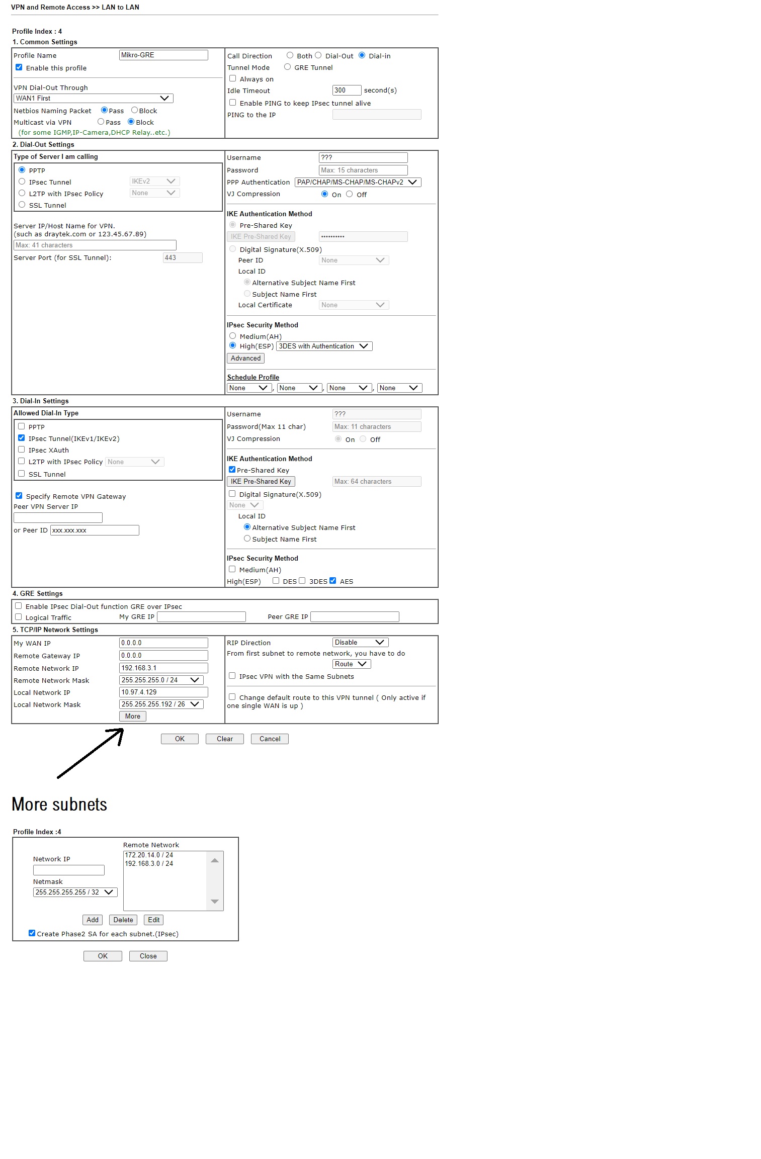

Do you know what traffic selectors are allowed by Draytek for the Mikrotik tunnel?
What do you mean by selectors?
If you mean the routes, the draytek has the routes for the two Mikrotik side networks 192.168.3.0/24 and 172.20.14.0/24.
In fact, when I had the other Draytek at home, everything worked fine…
Before IPsec is established both sides need to negotiate acceptable source and destination addresses. Either via traffic selectors (look it up, it’s a term) or the split tunnel extension.
On your draytek you will need to NAT packets coming from mikrotik before they leave for your server.
