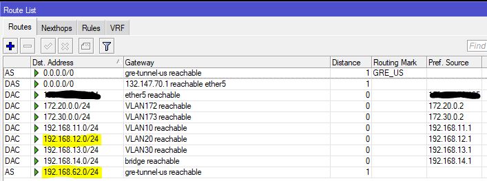

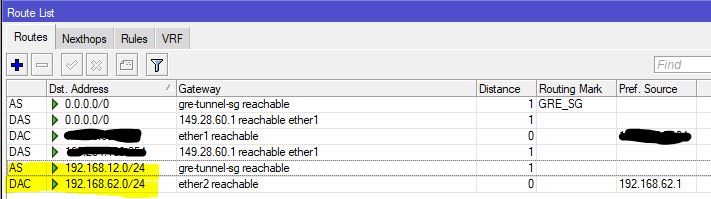

Router A:
Router B:

Although it is the best practice to locate each IP subnet to a dedicated VLAN, VLAN and IP subnet are not the same thing. So ignore VLANs for a while and concentrate on the subnets alone. In order that devices in subnet a.a.a.a on router A could talk to devices in subnet b.b.b.b on router B, a route to subnet b.b.b.b via the GRE tunnel must exist at router A, and route to subnet a.a.a.a via the GRE tunnel must exist at router B. Plus the firewall must not block the traffic of course.
And yes, GRE tunnel doesn’t carry L2 frames, only L3 packets, so no way to tunnel VLANs as such via GRE. But you don’t need that either, as said above.

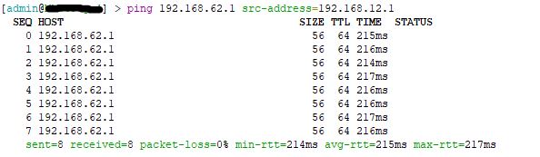

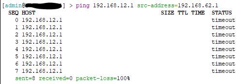

Thanks for your reply. Based on the routes I’ve already established, it should work right? Route table says gateway are reachable on both routers.
But ping times out from router A to B (but not vice versa)..
Pinging 192.168.12.1 from router A (timed out)
Pinging 192.168.62.1 from router B (Works as expected)
I can’t see any firewall activities either, so don’t believe firewall is blocking it. Just not sure where to go from here. Any pointers where/what could be causing the time out?

Sorry, the first thing I’ve spotted in your OP was that whilst there were four subnets, 192.168.11.0/24 to 192.168.14.0/24, at router B, there was only a route to 192.168.12.0/24 on Router A, whilst you wrote that “Router A, however, cannot ping any devices on the various VLANs”. So I wasn’t careful enough when reading the other details, assuming that you were testing on addresses for which no routes existed.
Now as you’ve stated again that the pinging works in one direction but doesn’t in the opposite one, and have shown the particular IPs you are pinging between to match the existing routes, as well as the fact that you’ve explicitly indicated to the originator the source address to use, it means that the route to 192.168.62.0/24 at router B and the route to 192.168.12.0 at Router A are both correct, otherwise the responses in the successful ping case would not come back to the originator of the ping.

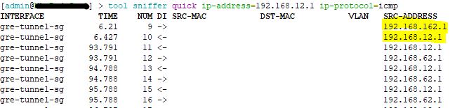

Sindy.. thanks for the sniffer command.. awesome tool that I didn’t know existed.
When I did the sniff on Router A..
It appears when IP address is assigned on the GRE interface.. the correct SRC-ADDRESS is used as per what I specified in the ping command
When I do not have the IP address assigned on the GRE interface.. the SRC-ADDRESS is actually my public Internet IP .. even though I have specified the src-address in the ping command. I believe RouterOS defaults to using ether1 when a bridge is not used?? ether1 is my “WAN” connection to Internet.. while ether2 has the 192.168.62.1 address assigned.
I would be careful with “defaulting to use ether1’s address”. For packets sent by the router itself, the route to the destination is found first, and only then the source address is chosen, using the properties of that route. If no pref-src parameter of the route is specified, RouterOS chooses the address associated to the interface which is set as the gateway of the route or, if gateway is an IP address, the address of the interface via which the gateway IP is accessible. A src-address eventually specified manually overrides both if it is an own address of the router, attached to any interface. And a src-nat (or masquerade, which is a src-nat with additional features) rule overrides all three. Why this hierarchy has failed in your case is not clear to me, nor it is clear to me why the public IP in particular has been chosen to overridde the one specified as src-address.

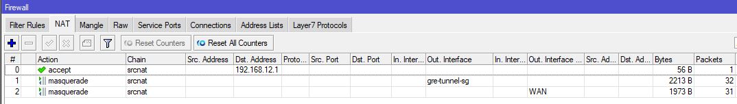

Can you add a rule chain=srcnat action=accept dst-address=192.168.12.1 as the first one in its chain in /ip firewall nat (to shadow any subsequent ones for packets towards 192.168.12.1) and see what the source address of the ping packets will be when no IP address will be assigned to the GRE interface?
Without IP address on GRE tunnel.. and with the srcnat added as you say..
Still times out with SRC-address of my public Internet IP when pinging 192.168.12.1
