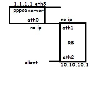

i want client to be abel to establish pppoe connect to pppoe server
inside RB i can establish a pppoe connect to pppoe server

what if i want eth2 10.10.10.1 can ping eth3 1.1.1.1

If the question is how a client behind a RouterBOARD can connect to a PPPoE server behind another port on that RouterBOARD, the answer is that as long as they have layer 2 connectivity it should just work. A PPPoE client sends out a layer 2 discovery message to determine the server and then negotiates the session from there. As long as client and server have layer 2 connectivity and nothing is blocking the discovery message the session should establish.
In your diagram it is unclear whether the lower router is a layer 2 bridge or a layer 3 router. The former would work, the latter would not. It is also unclear on what interface the PPPoE server is running, and why that router has an interface without an IP address and whether that interface is layer 2 or layer 3.

there is no brigge
routing could be that what i look for
eth0
