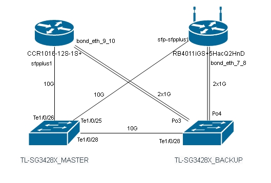

Here is my network diagram
My PC is connected to switch TL-SG3424X_MASTER which is on Po5.
Vlan 240 is for network administration.
I would like root port to be spfplus1 and alternate port bonding.
Sfpplus interface on both routers won’t become root port.

There is no Po3 and Po4 on TL-SG3424X_BACKUP, because i had to turn of ports (bonding/LACP) on routers or the is a storm and everything is unavailable.
Just to be able to connect back to routers i had to plug off switch TL-SG3424X_BACKUP, and then port role becomes disabled for bonding and designated for sfpplus.
When sfpplus and bonding are connected, on switch TL-SG3424X_MASTER i saw that Te1/0/28 is disabled by RSTP.
I restarted both routers and switches, but no change.
I experienced storm every time I enabled bonding/one port on router.
I tried to remove bonding/LACP but then root port is sfp port, not sfpplus port.
I tried to change values for bridge port priority, cost, internal cost, no matter what values I put, root ports on router are always sfp ports, not sfpplus ports.
I disabled edge port on both interfaces, but no change.

I read one post where sindy - Forum Guru wrote: “To make a bridge a root one within the network, you have to set its priority parameter to the lowest one among all the other bridges in the system, i.e. 4096 (0x1000). Google up why it is 4096 rather than 0 or 1.”, but i didn’t find why.
I changed CIST Priority on TL-SG3424X_MASTER to 4096 and on TL-SG3424X_BACKUP to 8192, but same result, root ports on router are always sfp ports, not sfpplus ports.
