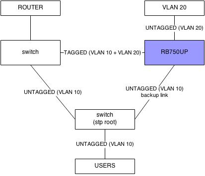

i have rb750up with tagged vlan.
now i trying to make link backup loop (only one vlan-id) but rb750up did not pass BPDU to my vlan..
rb750up config
vlan:
ether5-tagged is tagged port
/interface vlan
add interface=ether5-tagged l2mtu=1594 name=vlan-20 vlan-id=20
add interface=ether5-tagged l2mtu=1594 name=vlan-10 vlan-id=10
i need stp only on vlan-10
add name=bridge-20 priority=0x9000 protocol-mode=none
add name=bridge-10 priority=0x9000 protocol-mode=rstp
ports:
vlan-10 is root port
ether4 is alternative port
add bridge=bridge-10 interface=vlan-10
add bridge=bridge-10 interface=ether2
add bridge=bridge-10 interface=ether3
add bridge=bridge-10 interface=ether4
not interested network
add bridge=bridge-20 interface=vlan-20
add bridge=bridge-20 interface=ether1
vlan-10 should be marked as root port but it dont.
if i add “ether5-tagged” to bridge then this get marked as root port, but then all my tagged traffic has passed to ether2,ether3,ether4 (unacceptable for me).
why BPDU not passed from ether5-tagged to vlan-10?

brefly: how can i use rstp on one vlan?
