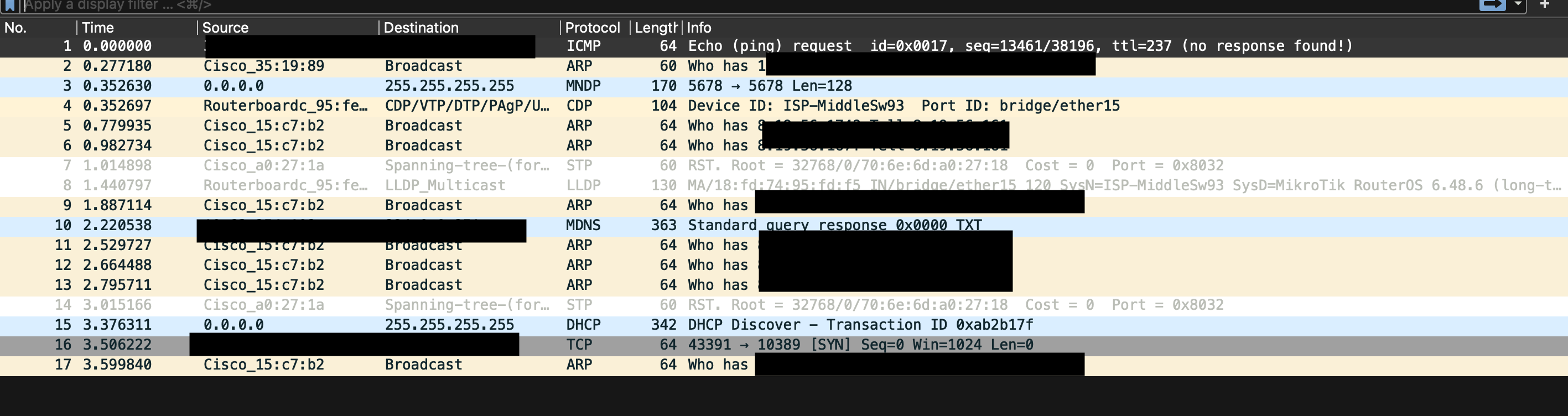

Unfortunately, sending-rstp shows yes even on a port that is configured as edge=yes and sniffing shows that indeed no BPDUs are sent out via that port (whereas it does show them if the port is configured as edge=no, so it is not a sniffing issue).
So apart from this misleading indication, what is the actual issue you need to address?
Well at the moment the situation has been sorted out.. But in certain situations when we get our internet hand off from our provider for our events, they mainly use ciscos and even tho we are almost 100% Mikrotik now, we do still have some ciscos in our switch environment. We would have ports shut down from either native VLAN mismatch or from some BPDUs that would flood past our Mikrotik swithtports.. Granted that has happened less since I started using those switch rules that I posted before. But at this event they were telling us that there were seeing spanning tree issues when connecting to us.. and I just wanted to be ultra sure that my switch wasn’t passing anything. I did do a sniff and I did not see anything like that.. ill post the capture here..
