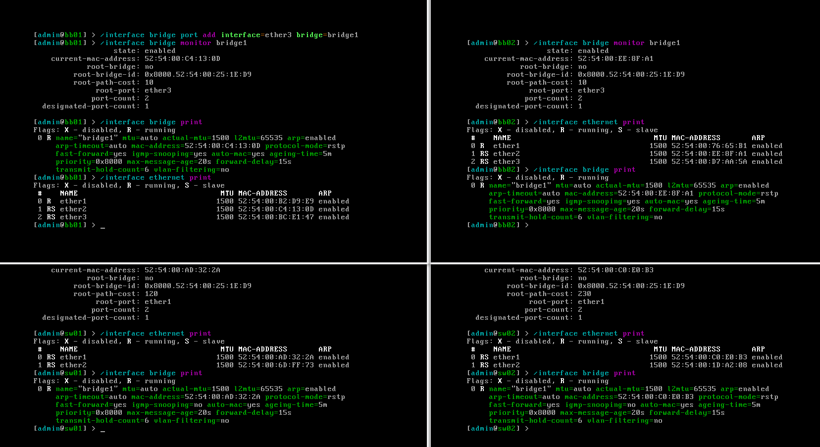

I’m just starting a new network setup. It’s a simple topology:
<–ether3> bb01 sw01 sw02 bb02 (to bb01)
bridge1 is created on each device, with RSTP enabled. The ports listed above are added to the bridge.
I can ping between them. But no bridge shows that it is the root-bridge!
Both bb01 and bb02 say its root-port is ether3, which faces each other!
And the root-bridge-id is a MAC that I cannot find on any device… any ideas here?
See attachment for the print output of the ethernet and bridge per device.
Thanks!
Edit: Well, mea culpa on this one. Took me a while to get back to this, but I didn’t mention here that I was actually doing this in qemu with virtual bridge interfaces created on the Debian Linux host, and being used to connect the RouterOS instances together. Turns out Debian/libvirt enables STP on bridge interfaces by default. Meh.
