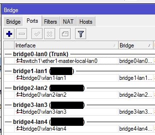

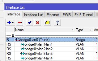

I use Vlans on that bridge and those vlans are bridged to ethernet ports etc. So, as I understand, I can only use RSTP on my first bridge/trunk?
