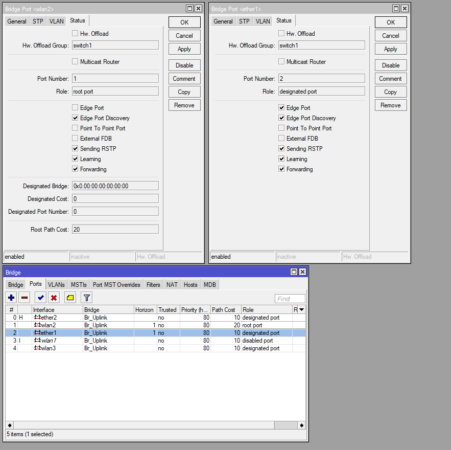

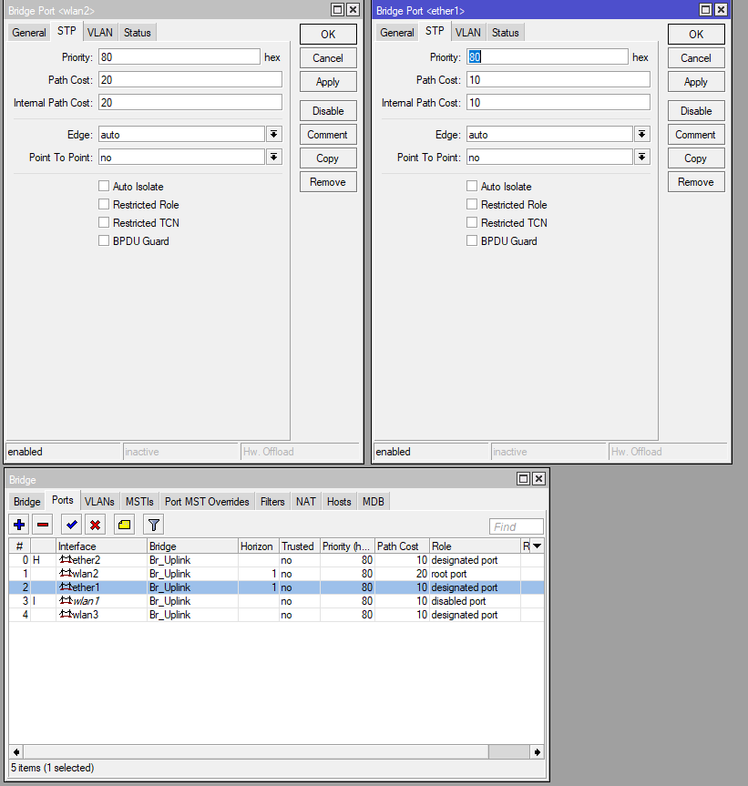

Hello all, I have connected two Hapac2 using wlan2 and eth1.
On first Hap, i have a brisge with priority 0x0000 and is promoted to root bridge.
On the second Hap, I want to have the Ethernet 1 as root port and the forwarding one, if it fails i want the wlan2 to change to forwarding.
I am not managing to obtain the setup, my wlan2 is always the root one and the eth1 is the designated (no backup or alternative)
I have read the manual 50 times at least, i have read the wiki and nothing seems to have sense except the root bridge, that i manage to setup as desired.
Anyone can see where i am wrong?
