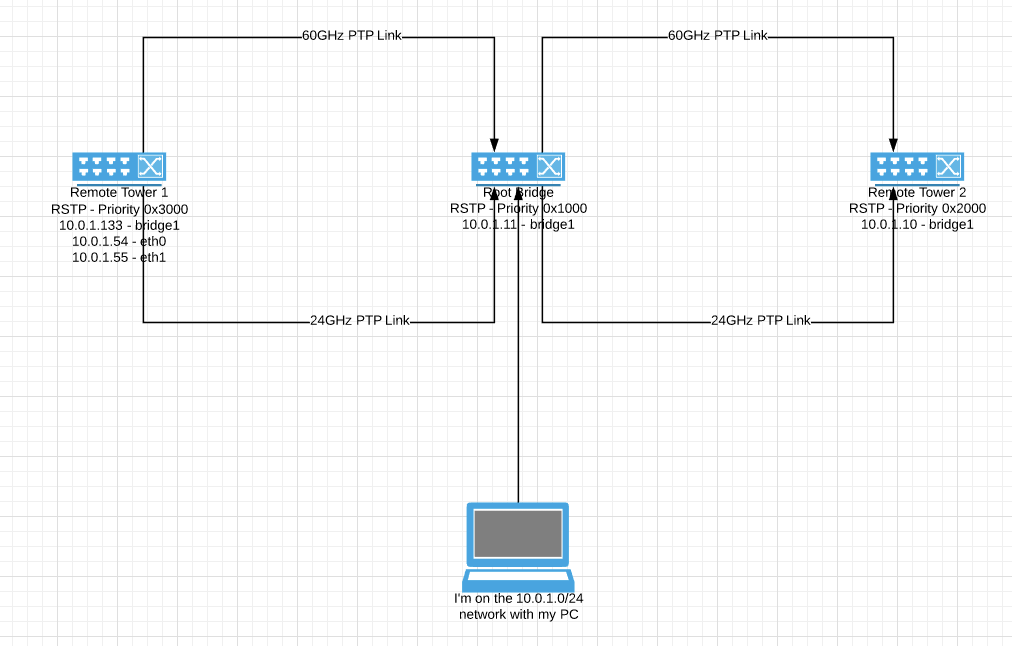

I have a scenario with two CRS326 switches that have a dual wireless connections (for redundancy).
CRS326 #1 → port 1 → 60GHz PTP link → port 1 → CRS326 #2
root bridge → port 2 → 24GHZ PTP link → port 2
CRS326 #1 and #2 have IP address on their bridge port (all ports of switches are on the bridge on each unit)
When I enable port 2’s I see the proper RSTP topology formed, BUT I lose connectivity to CRS326 #2.. I can no longer ping it.. If I MAC telnet into CRS326 #2, I can disable port 2 and I can reach it again..
Something about turning on RSTP causes the non root-bridge port to lose connectivity (only to itself, it is passing traffic correctly over the lower path cost redundant link).
any thoughts as to why that might be??
cheers!
Paul

thanks for the response. Some things to be clear about.
  1. No VLAN’s at all in this setup.
  2. root and alternation ports are selected by the switches (non root switches) correctly based on path cost..
  3. pinging stops working INTERMITTENTLY to 10.0.1.10 or 10.0.1.133,etc any switch OTHER than the ROOT switch, whether it’s an IP on the port of the switch or the bridge on the switch from the PC in the attached diagram.
  4. from the PC I can ping to the core ROOT bridge switch (10.0.1.11) perfeclty.. no loss.. If I disable the redundant port on either of the NON root bridge switches I do not have this problem.. It seems to be directly related to having RSTP takeover.

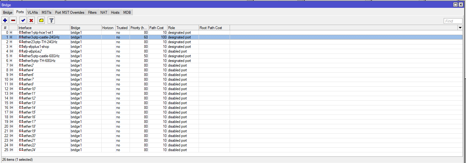

So - in my mind I think it is an issue with the ROOT BRIDGE not disabling the backup port.. see attached image.
  1. In the image below of the ROOT BRIDGE (/interfaces bridge port print) list you can see the paired ports
Remote Tower 2 (in our previous example)
ether3-ptp-castle-24GHz
ether5-ptp-castle-60GHz
Remote Tower 1 (in our previous example)
ether2-ptp-TH-24GHz
ether9-ptp-TH-60GHz
They all show a Role of designated port.. Shouldn’t the port that is disabled show up as “backup” role instead of all of them being active and designated? Remember this is the display on the root bridge. It’s as if the root bridge has no idea which port is active, and perhaps tries to send traffic out both, and this may explain my issues of erratic behavior?
I’ve tried modifying port priority or path-cost to get the ROOT BRIDGE to prefer specific ports (as we had done on the NON ROOT BRIDGES), but there is no change in the ROLE type.
Nope, a root bridge can’t have a backup port. It’s on the other bridges to turn ports into backup.
I guess the 60GHz link is MikroTik?
What is the 24GHz link? Is it an AirFiber? Is WDS enabled on it?
Is any STP-flavor definitely disabled on the w/l links?
I had some similar issues a while ago when STP (MSTP in a Cisco-only deployment with a w60g link as a backup in my case) went totally nuts once both links were active.
In my case (which is about 18 months (and hence a lot of routerOS releases) ago) my solution was to disable neighbor discovery on the wap60g and adding bridge filters that block input and output from/to mac 01:80:C2:00:00:00, but lets it through in forward chain).
I never dug deeper in it but that solved it for that situation.
And, as long as you’re still debugging STP, I’d avoid setting path-costs and port priorities manually. That can be done as soon as STP is working.
-Chris
Indeed the 60GHz link is a Mikrotik and the 24GHz link is a Mimosa B24.. I don’t see any fine control options for STP for the Mimosa, but I can defintely try those things on the Mikrotik 60GHz links.. I’ll try and report back. I did notice that RSTP was ON, for the 60GHz links
