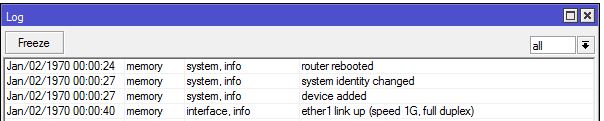

I have still no success.
It is running a bit of the script but not all.
Below a little bit for the script (only the beginning).
It change the identity and add a bridge but not add ports to the bridge. (see screenshot

you can add
:delay 15s
http://forum.mikrotik.com/t/netinstall-defaul-configuration/118190/1
Great,
The :delay 15s helps me a lot
Je hebt de…sorry in English now, you have missed the startup delay and when I understand the two postings above you can put as first line in the config.rsc :delay 15s and that would do it.
