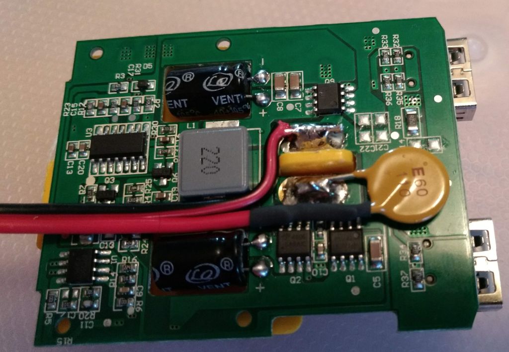

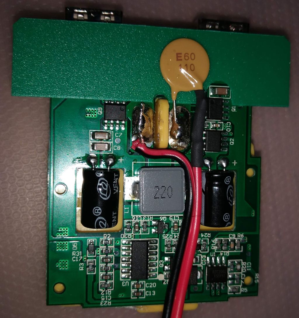

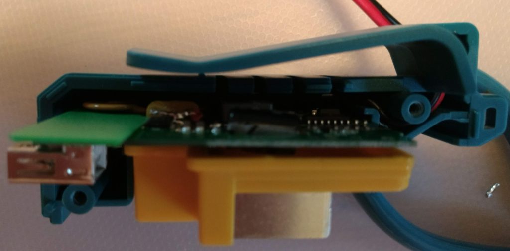

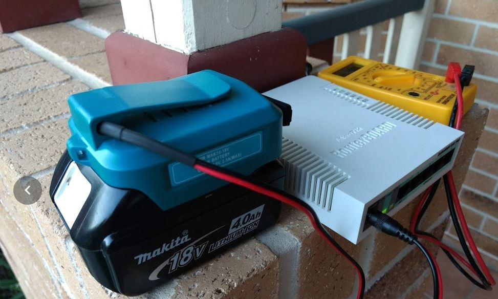

For surveying, a power source from a Makita tool battery pack works well. Here’s an adaptor you can make -
https://www.thingiverse.com/thing:352094
Contact block -
https://www.thingiverse.com/thing:863257
Or you can purchase a clone Makita USB adaptor and modify it with a cable from the raw 18v battery -
https://www.makita.com.au/building-construction/category/clothing-lifestyle/adp05-18v-mobile-usb-charging-adaptor
I’ve done this and it’s great. A medium battery lasts hours and the new ones have a charge LED bar indicator (4Ah).
Wow! This is exactly the sort of thing I was looking for. It seems like the Makita packs use 10 x 18650 batteries, and judging by the voltage the configuration might be 5S2P (5 cells in series, 2 parallel). Have you run them from full to empty? If so, how long did they last on average? Also is that the RB951G-2HnD I spy? :smiley:

Here’s some internal pictures to give you a start.

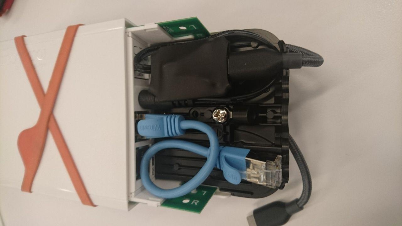

I use a power bank with USB-C power delivery output. Combine that with a PD Buddy Sink and you are done.
The PD Buddy Sink even fits into a wAP (LTE) case - resulting in a powerful mobile access point.
Thank you for the starting point! Your setup seems quite apt and nice bit of engineering with the cable routing.
